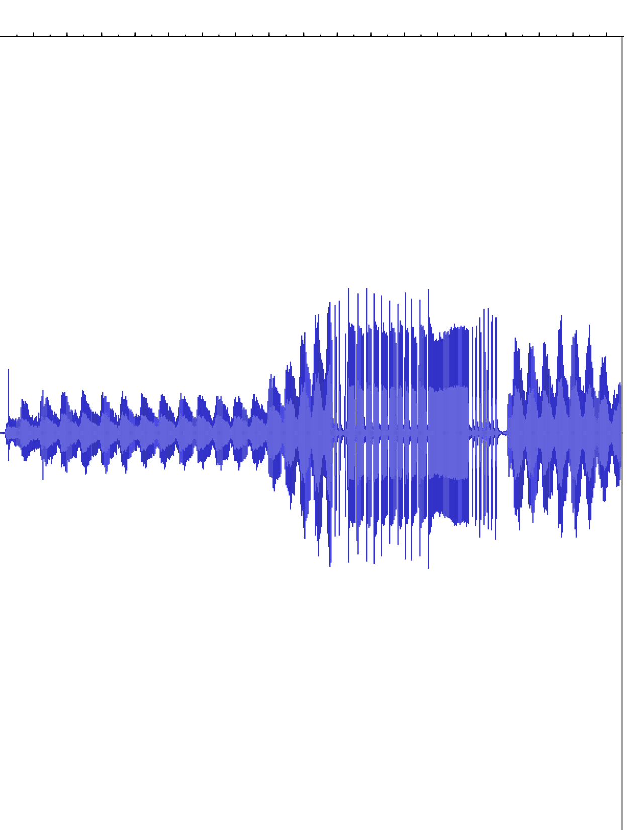

I used the video, my hearing and the program called Audacity to make the squeaks from the car alarm. The starting lower frequency is about 1500Hz and it ramps up to 2400Hz. It repeats at about 2Hz.
