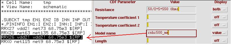

Hello everyone,
I have two kinds of res---rnpo&rnhr,and the model name fill in the blank of Model name,use CIW export->cdl,but there is only one res---RP in the netlist,how can I take the netlist with different res?
Thanks.
Please change CDF. in icfb menu, Tools-> CDF->Edit your library with base type. Find the cdl option for resistors.
As you say,modify the model name of res from RP to rnpo,export->cdl,netlist still have only one type of res(rnpo),but I have two kinds of res.What can I do then?
You must have several tries. Soemtimes it has some mistakes in your CDF.
Maybe I didn't take the expression correctly yesterday.
I want to have the netlist as follow.The model name rnhr500_mm replace RP.
