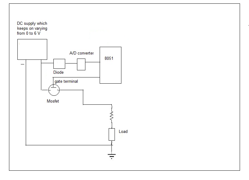

well i am trying to build a switch using power mosfet and a microcontroller which can turn on only when the voltage is beyond 5 volts. (max voltage will be 6 volts i think )
For this my zener diode will act as an indicator , which when connected to an ADC , will send an signal to mc . (well use of mc is very important as i have to perform additional tasks using this mc kit ). MC in turn will send in gate vltg to the mosfet for turning it on.
i am attaching a basic block diag representing d ckt
If you are using ACD, no need for the zener diode.
You may use a voltage divider (two resistors in series) on the ADC input and let the microcontroller to compare the ADC output data with a preset value to decide when to shutdown power…

then according to my above ckt diag , am i going correctly ?( except the use of zener diode of course )
Do i need to make any more changes to it, like a use of an DAC between mc and the gate terminal of mosfet ? I think so 'coz the mc will b sending out digital signals , so will it be enough to control the gate terminal vltg.?
Seems u building a Mercedes to go to the local shop to buy beer .
Why not build a simple comparator ( with a resistor and 5v zener diode) that will switch on a mosfet or relay that will supply the load . if u must use mpu cause there is another reason then shank idea is perfect
No need to use DAC. :smile:
