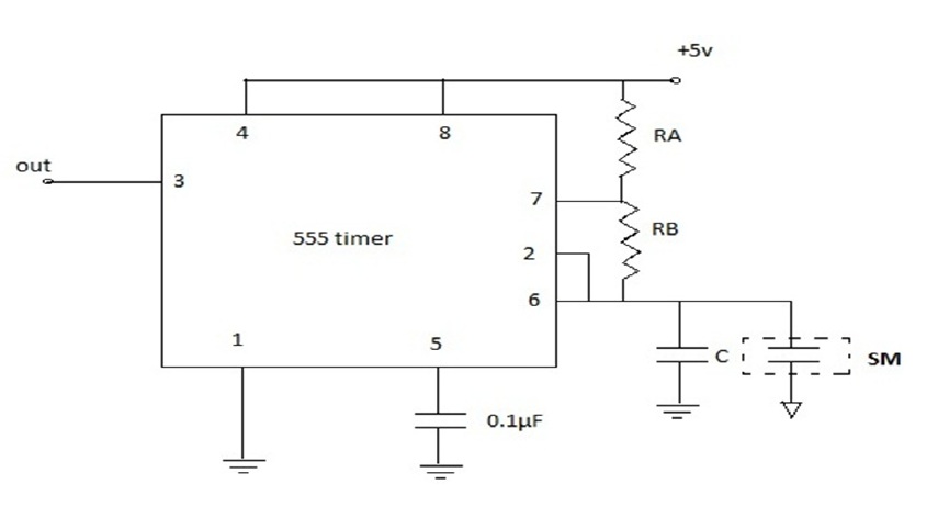

I found this circuit..frm internet is it ok?
---------- Post added at 23:45 ---------- Previous post was at 23:43 ----------
I dnt knw the relationship betn Ra and Rb..
and wer do i connect the other terminal of soil sensor..?
This timer will output a Logic level clock that reduces in frequency when capacitance is added. Generally in audio range, not MHz Range, DC sensitive unless R pullup is << 10KΩ. So it would work like a reverse Tach .. moisture to Hz convertor... yes
Not the best.
What do you need for output?
what if i connect the o/p to the interrupt of a microcontroller..? or if i connect it to a led will it keep on blinking?
I also have a question in the above circuit..i cant get where is the other terminal of the soil moisture sensor connected to? I mean the 1st one is connected to terminal 6 and what about the other terminal....?
The 555 timer specs will tell you how it works. THe Cap is charged to a threshold in an oscillator condition with a current source regulated by a reference voltage, internal current pump, external resistance and capacitance. Cm is the external cap in this case connected to ground. You need stainless steel or nickel plated probes.

Could you please post the correct Resistive moisture sensor diagram?
There was a project that detects when soil becomes dry but it didn't work so I fixed it. I built many of them.
1) It uses an AC signal at the stainless steel probes.
2) When the soil was damp the LED was turned off so its two AAA alkaline cells battery lasted for months.
3) When the soil dried a little then the LED dimly blinked.
4) When the soil was very dry the LED blinked brightly.
I removed the parts that blinked the LED and I filtered its pulse-width-modulated output into DC and somebody said it gives a good DC output:
