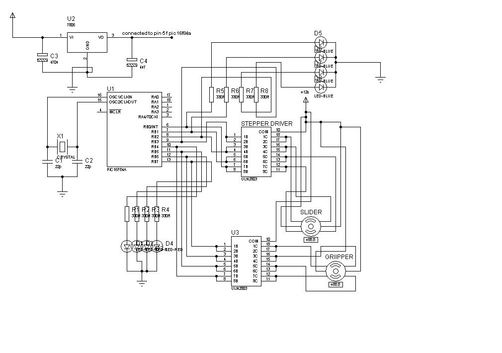

help me with my code and my circuit.i made a linear robot,,,it will grip then slide to opposite position then go back to its original position..
the problem is the stepper motor i used did not work properly..it only vibrate
here is the code
here is the code:

here is the circuit:
if you have idea please help..

it is necessary to define an external clock like xt in the program?
If you intend to use external crystal then you have to. Otherwise I think it internal clock default.
Thankyou
thank you very much...
maybe that is the problem why my project don't run well..
