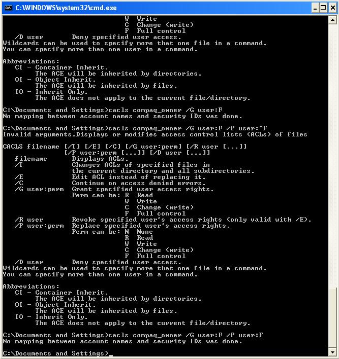

My computer came crashing down this weekend. Fortunately I had some back up but some of the files were not spared at all. However, the solution was just to resinstall the OS but I have to recover some files on my documents and desktop folder.
1.) the compaq_owner folder (the user account where my documents and my desktop need to be recovered) user account always denied access. and the file size is zero. The system just locked it up and i cannot access the my docs and desktop folders in it.
OS used: Windows XP
2.) I played around the DOS commands and and I saw this CACLS command but never successful in using it.
Can somebody plz help me recover those files.
Thanks
Here's some of the responses in CACLS DOS command
https://obrazki.elektroda.pl/65_1185837516.jpg

Re: File Recovery Help
Hi!
There are two possible reasons for you having access denied erros
1. Having a virus/ worm in the PC.
There are few symptoms of having worm - it will deny you the access to
the documents folder your specific user account but not other accounts.
if you are able to login in safe mode or safe mode with command prompt then try to create new user. You can make out if there is a virus in the system as it will not allow you access your documents folder from that new user login. now you have to log off and log on using your original account. copy all documents and mail from my documents and mail folder to root directory of Drive C in any folder say backup
2. Having a file system error.
Though this seems like a big problem - no need to panic. just try On track data recovery - I had tried it to recover 250Mb data from my hard drive as XP's file checking programs converted all folders to files and I was helpless. Try to connect any removable media as restoration drive. do not attempt to save recovered files on the same drive. If you are not able to access the external drive, then try to connect your laptop hardisk to any desktop PC via USB to IDE interface. and recover.
