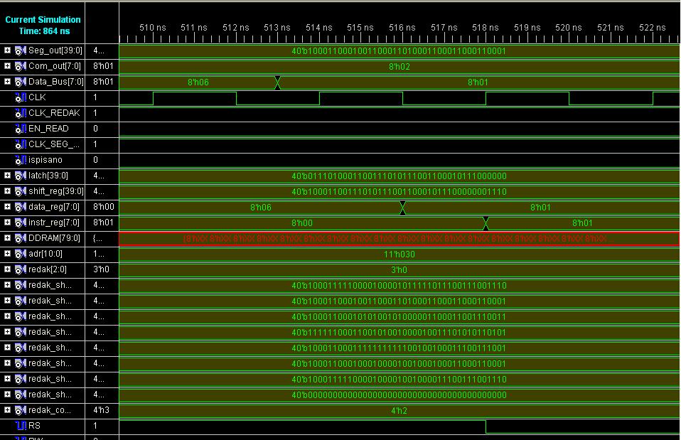

Re: HD44780 fpga core
Guys, i've done this so far...
i'ts on croatian, so maybe it will be hard to understand,
but you will probably figure it out!
module HD44780(
			RS,
			RW,
			E,
			Seg_out,
			Com_out,
			Data_Bus,
			CLK, CLK_REDAK,
			EN_READ,
			CLK_SEG_OUT);
		input
		RS, //mpu
		RW, //mpu
		E,  //mpu
		CLK,
		CLK_REDAK,
		EN_READ,
		CLK_SEG_OUT;
		//taktni signali
		input [7:0]Data_Bus;//ulazne naredbe 8bitne;
		output[39:0]Seg_out;//segmetni signali - stupci
		output[7:0]Com_out;//common signali - redci
		reg[39:0]Seg_out;
		//reg[7:0]Com_out;
		//reg[7:0]Adresa_znaka;
		//reg[2:0]Adresa_retka;
		reg[7:0]data_reg;//podatkovni registar
		reg[7:0]instr_reg;//instrukcijski registar
		reg[39:0]shift_reg;//shift registar za segmente signale
		reg[39:0]latch;//latch koji sprema sadr¾aj shift registra za seg_signale
		// reg[7:0]shift_reg8;
		reg[2:0]Adress_counter;
		reg Busy_Flag;
		initial instr_reg = 0;
		/////DEFINIRANJE INTRUKCIJA//////
		always@(posedge E or RS or RW)
			begin
				if(RS==0 && RW ==0)
					begin
					instr_reg = Data_Bus;
					end
				end
		/////////DDRAM////////////////
		reg [7:0] DDRAM[79:0];
		///////CGROM/////////
		reg [4:0] mem [55:0];
			always@(CLK)
				begin
					mem[0]=5'h00;//space
					mem[1]=5'h00;
					mem[2]=5'h00;
					mem[3]=5'h00;
					mem[4]=5'h00;
					mem[5]=5'h00;
					mem[6]=5'h00;
					mem[7]=5'h00;
					mem[8]=5'h11;//H
					mem[9]=5'h11;
					mem[10]=5'h11;
					mem[11]=5'h1F;
					mem[12]=5'h11;
					mem[13]=5'h11;
					mem[14]=5'h11;
					mem[15]=5'h00;
					mem[16]=5'h1E;//D
					mem[17]=5'h11;
					mem[18]=5'h11;
					mem[19]=5'h11;
					mem[20]=5'h11;

this is what i've and it gives this on output, if you look hard you can see the output HD44780 on redakshift registers ;) :
