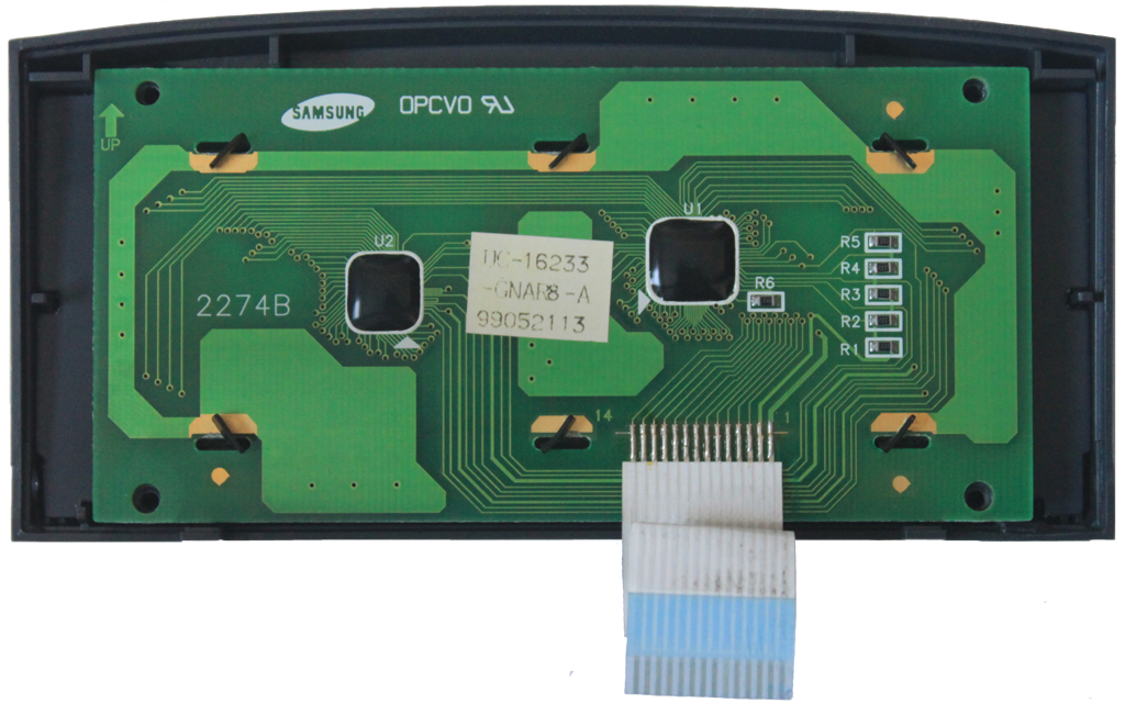

I have a display module that came out of an office phone, and I am trying to find out what it is, the controller that runs it, and how to interface with it.
The numbers on the back of the board are
CD74601
Rev. 3
OPCVO
It appears to have 2 chips, both covered by a black blob.
It has a 14 pin ribbon cable, and 14 pin thru hole socket.
Any help would be greatly appriciated.
I can take pictures of it if you want, though they will be of low quality, as i only have a camera phone.

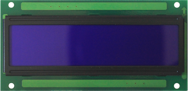

Is it possible to take some pictures of this display and post it here?
How many lines and columns it has?

primarily the two chips are the encoder/decoder for the LCD display in that phone. Is the LCD display of your phone is monochrome?

Re: Help identifying LCD module HD44780
**broken link removed** I know a very old post but maybe someone will need it
file.php
   1   -   GND
   2   -   +5V
   3   -   Vee
   4   -   RS
   5   -   R/W
   6   -   E
   7   -   D0
   8   -   D1
   9   -   D2
  10   -   D3
  11   -   D4
  12   -   D5
  13   -   D6
  14   -   D7
