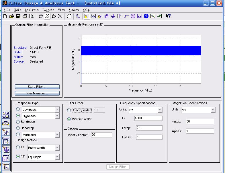

Hi, I am a beginner in this field. I'm in a project and need to design a highpass filter. It is used to remove the DC offset. It has a cutoff frequency 2Hz, also needs enough attenuation about 30dB. I try to design it in the MATLAB used FDATOOL. But I failed~~~can I use the butterworth method or something else

So thanks for your help, but I really don't know much of it. This highpass filter used in a digital filter(decimator) for sigma-delta ADC. I have designed the CIC, unsinc and fir filter with matlab. But in a similar design I find there has a highpass filter at the end of the digital filters in which it just says the highpass filter is used to eliminate the DC offset. So i just want to add this highpass filter in my design to see what will happen. But I don't know how to design such a filter, I just try in the FDAtool. But I failed. Is the cutoff frequency 2Hz too small to achieve? I could't get a 2Hz cutoff frequency and the nearly -30dB attuation together. can you tell me which design method in matlab is mostly suit such highpass filter?

maybe the minimum frequency must pass through the filter is 3-5Hz. I'm not sure now. I forget to say that the input frequency is 48kHz, so is it hard to use the iir or fir filter to do it? maybe you are right. the coupled capacitor is a better choice. I just used the equiripple method to design a highpass filter in matlab. I attach the figure below. It is so hard to implement in hardware because the FIR needs 11418 taps, the attenuation is too small either.

Up to now I never have heard that somebody has used a digital filter only to remove a dc component.
