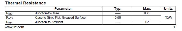

The IRF3205 has given a graph
See this graph, if your not stressing up your MOSFET.In the datasheet it's also seen that the maximum safe temperature is around 62 degrees Centigrade/W.
Power=12*850mA(Less than 1 Amp)
Power=10.2W
You have 62'C per W
so 62*10.2=632'C
That much temperature 632, this can't be true.Some one explains about thermal thermal resistance and about 62'C per Watt.
