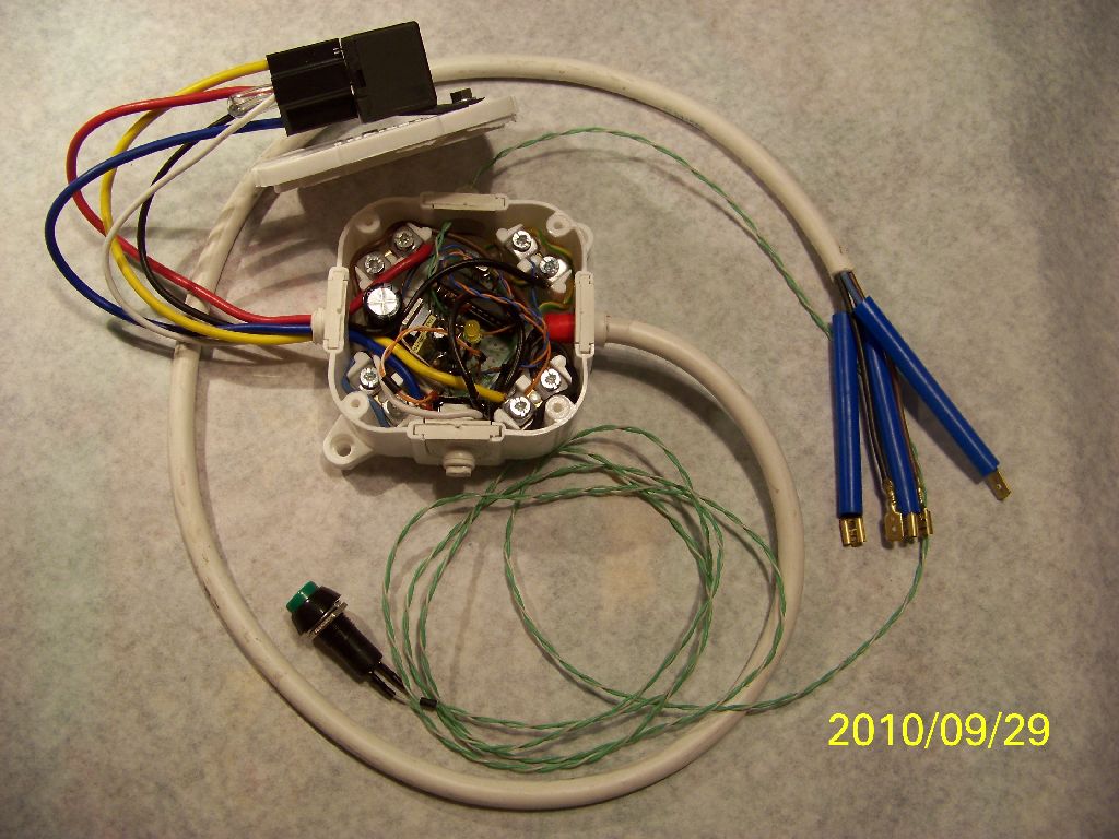

The system was made to be installed under the hood of the car and connected to the wiper motor connector in a way so you can choose to use „intelligent” control or original wipers system.
Some pictures of the system, assembled and disassembled:

How it looks:

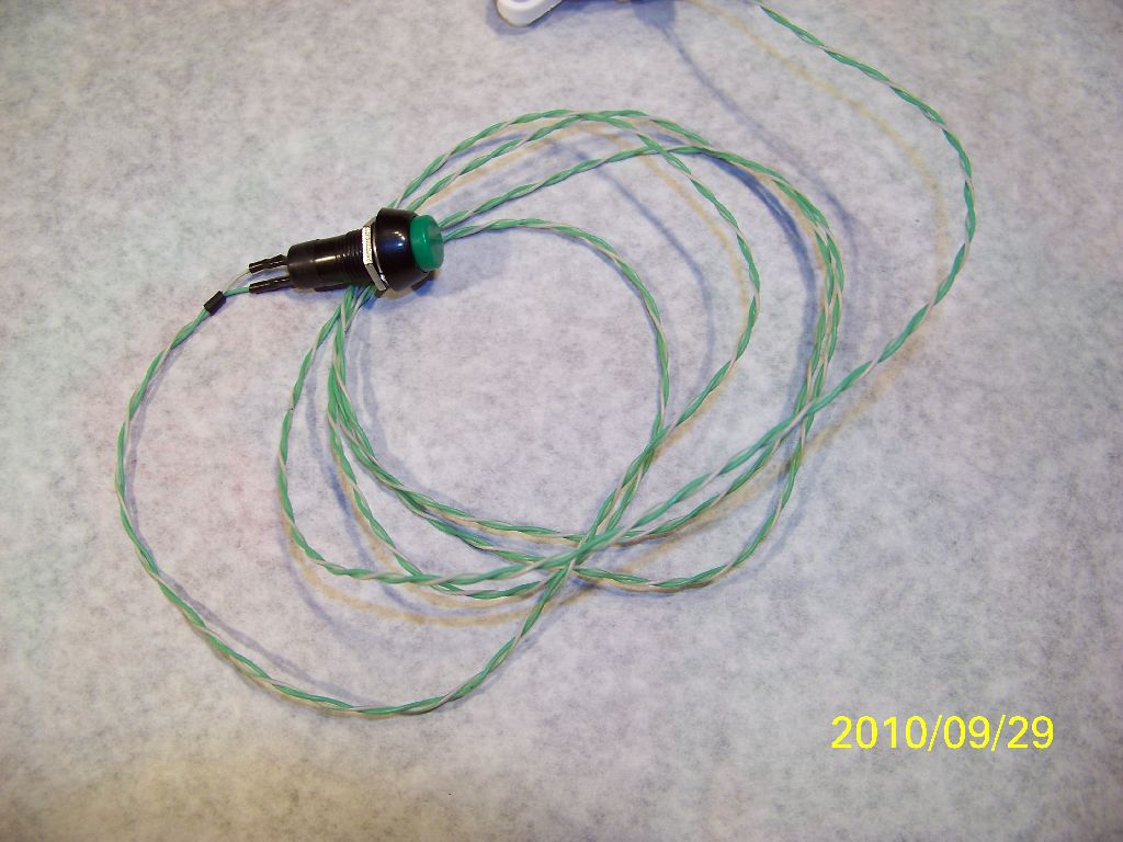

Multifunctional button: on, off and change of wipers operation frequency. Any button that shorts the contacts when pressed and opens the contacts when released.
