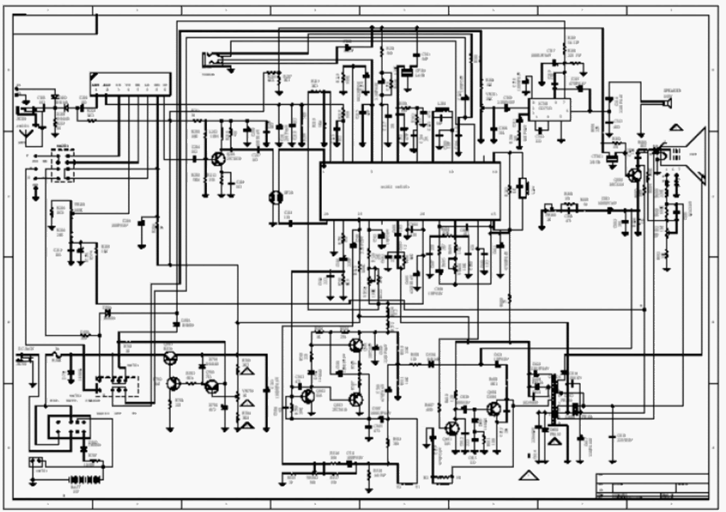

Its a little b&w roadstar 12v/240v with a 5.5" screen, the tvm5002 is very similar, the controls are the same it looks like a cosmetic upgrade of mine, I cant find diagrams for it except for a nasty one linked below scanned from the user manual (not by me), roadstar probably thought it a disposeable item and didnt print any.
Theres a single ic managing the deflection and the gun by the look of it, and a uhf/vhf tuner head at the back, if I'm lucky the tuner will output composite and all I'll need is to match the level.
https://i807.photobucket.com/albums/yy352/widgidibbie/55TvSchem.gif
The last connection on the tuner can goes to a tranny which is driving a transformer connected to the controller chip, could this be a compo video in, or is it just gonna be IF in or something no use to me.

I'm a twonk, I got that schematic from the net last nite and posted it here, its for a set similar to mine, what I didnt notice is that the schematic is for a set that has compo video in, mine doesnt have that, but mine has the same chip, the ka2915 and a ery similar schematic, if I'dve looked a bit harder I'dve seen before I posted that the schematic clearly shows a video/audio socket.
I found a cool vid on youtube for converting the same set mine to audio/video in (link below), this guy disconnects the compo video output from the chip and connects it to a video source using it as an input instead of an output, I wondered about doing that but I thought the impedance of the ic's output would be to low to inject video to it, but this guy got it to work.
The ka2915 chip is probably quite common in cheaper 12/240 sets so this might be usefull for other readers.
Gonna remove the tuner can and the audio pa to save power, and make the telly into a video monitor, I'll probably mod the circuit so's its the same as the schematic I posted as that was a manfacturers trick, probably more reliable than the youtube mod.
