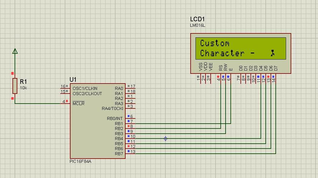

frist we send 0...3 bits on register f to port B!right?
ok! but 4...7 bits on register f are 0 so RB0...RB3 will be 0 and this is my problem!because I wanna use RB2,RB3 for other instructions!
you now the ascii of 'A' is 65! I wanna show 65 on LCD not 'a'! but I don't know how to do it!
