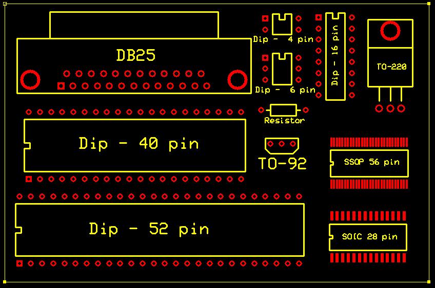

i want to make a clear desiging of my circuit on a pcb , so i want to make the design not only with copper platings connectors but with hole explanation there too , i designed in some softs but not able to mark holes there , actually i want to specify hole location so as to make ICs & other deligate components to be install properly in place with no stress , i jst want to make it like as we find them in market . Not much perfection clearity but needs connecting plates & holes simply , Too i ll make it with a simple chemical process further but please let me get a simple soft first
For me, the most simple software to make PCB designs is ExpressPCB. It is easy, flexible, simple & limited, and has basic component's footprints for your ease. So you no need to specify holes and pads all the time. You can make your own footprints and save them.
footprints bole to ? i mean here footprint means ?
Footprints means the original shape, size and positions of a component's pins. It is required to draw the PCB layout. They are already designed and saved in the software. Download and check it. You will understand. Here is an example....

The drill size is not an issue, as in India, probably all the PCB manufacturers uses manual drilling. So obviously they do not follow the drill size specification from your design. The will use same drill pin for every pad.
In ExpressPCB, all the DIP components have a very thin pad. You can't solder with that. So I recommend you to change the drill size according to your convenient. Follow the following tutorial...
1. First organize your components in the way you want. You can see the pad size is very small. Click on the component to select it.
2. In the menu bar, go to COMPONENTS> UNGROUP PCB COMPONENTS. Now all the elements of the component including the pads are edit-able.
3. Double click on each pad and select the desirable pad size. I would recommend pad size of 2.01mm or more. [DO NOT CHANGE THE ALIGNMENT OF THE PADS. THEY ARE POSITIONED BY JEDEC NORMS(2.54mm)]
4. When you are done editing, select all the elements of the component, go to COMPONENT> GROUP TO MAKE PCB COMPONENT.
This way you can make your own components and can save them.
Hopes this helps..

For hobby project work, high quality PCB's are not needed. So I asked to neglect the drill size, since you are a hobbyist. But for professional work, you will get the exact PCB as per your design from your manufacturer. In ExpressPCB, design is simple, but there is only one catch... They do not provide any support to solder masking. Either you have to make the mask manually, or you have to give your design to ExpressPCB to manufacture. Right now, I am facing the same problem. Today I was supposed to give my design to my local manufacturer, but they said they need a masking file. :-?
