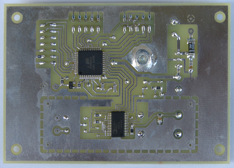

Construction
The device is made on the basis of the popular system of direct synthesis DDS AD9851 from Analog Devices, controlled by a microprocessor Atmega16 from Atmel. The system AD9851 is clocked at 216MHz with quartz generator. For the safety, the system has a heat sink which also serves as the screen for DDS synthesis. This solution works even when the generator runs 24 hours a day. Microcontroller's software was written in C and assembler, which resulted in a full program FM modulation. AM modulation signal is created by a microcontroller, but it is connected to the synthesis through an external circuit. Of course, a synchronization signal at vobulator work is also created by the microcontroller. To communicate with the user, the device uses alphanumeric display 2x24 characters and 7-button keyboard.
