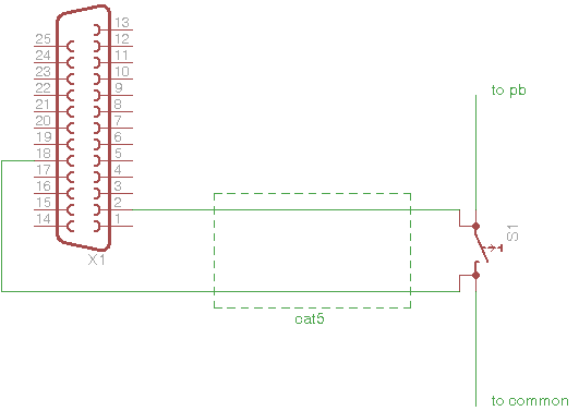

It sounds like this is your initial plan:
Do not do this! Connecting the ground and 4.2V and lines from your parallel port to the switch will do a few undesirable things:
  • It will bring your machine's power supply ground to the same potential as the "common" connector on your garage door circuit, which may or may not cause problems.
  • It will short your parallel port data pin to ground when you press the real garage door switch which is probably not a good idea.
  • It will cause the garage door circuit to drive all the current that would normally go through the switch through your parallel port instead, likely damaging your computer.
  • It will most likely not open your garage door, or will open it exactly once while frying your parallel port in the process.
The garage door circuit relies on being able to drive current through the switch when it is closed, your parallel port is not an appropriate device to close the circuit with.

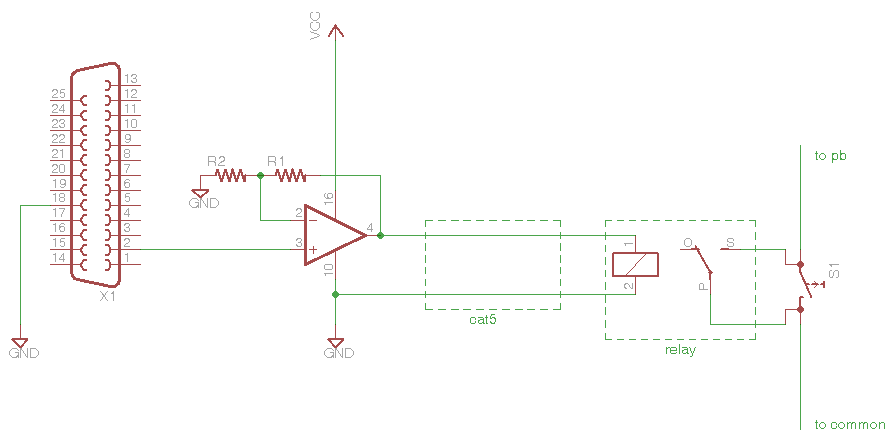

One solution is to use a simple relay with the contacts across the garage door switch and the coil controlled by your parallel port buffered through an op amp or optoisolator. This is a very basic circuit, will maintain isolation between your parallel port and the garage door circuitry, won't damage your parallel port, and also won't interfere with the normal operation of your garage door switch. A relay is just a magnetically controlled switch. It basically simulates pressing the button, e.g.:
The reason for the buffer is because parallel ports can't really source enough current to drive a relay. AFAIK there is no standard minimum, they vary anywhere from 2-16mA, so your best bet is to assume the worst and don't pull more than 2mA from your parallel port (2.6mA is the limit given at **broken link removed**). The op amp will drive the relay coil through your computer's power supply instead of through the serial port.
In the above circuit:
  • GND represents your machine's ground (the parallel port grounds are already connected to it, it is shown in the circuit for clarification -- do not make that connection explicitly or you may create a ground loop).
  • VCC is the op-amps supply input and should be connected to a suitable power supply source from your computer (e.g. the +12V line from an ATX power supply).
  • R1 and R2 should be chosen to amplify the voltage to whatever the relay coil requires. E.g. a 5V relay would require a gain of 5/4.2 ≈ 1.2 and gain = (1+R1/R2) so e.g. R1 = 13K and R2 = 68K would get close enough (good tool: **broken link removed**) and would give you 5V out from your 4.2V in.
  • S1 is the existing garage door push button switch.
  • The relay switch is connected in parallel to your garage door switch. It should be connected to the normally-open side of the relay (energizing the relay coil will close the switch).
A word about choosing components and values:
  • VCC must be > required relay voltage with allowance for op-amp's maximum output swing (rail-to-rail op amp would be required if you only have 5V VCC and relay also requires 5V, single-supply op-amp required if you're using 0V for negative op amp supply as in my diagram, although you could always use e.g. the -5 or -12V atx line - but don't connect those to system ground! you'd run your relay off lpt ground pin and op amp output in that case).
  • Op-amp max output current (sometimes called source current) must be greater than current required by relay coil (I'd say 20%-50% greater to be safe).
  • Relay contact rating must be greater than current that normally flows through garage door switch (which is probably small). You can measure this by setting your meter to DC current mode and touching the probes to both sides of the switch (don't be surprised when this opens your garage door). Same with relay contact voltage rating. Again add 20%-50% to be safe.
  • CAT5 cable can handle it fine. CAT5 cable resistance IIRC is about 1.2Ω/100ft. which will be negligible for the distance I imagine you running it.
So you must choose a relay, op-amp, and VCC source that are compatible with eachother, then choose an appropriate R1 and R2 based on the relay voltage (btw see http://www.allaboutcircuits.com/vol_3/chpt_8/5.html for more good info on op amps). If you tell me what VCC options you have available and what the current going through your garage door switch is I can help you spec out parts.
You could avoid the whole buffering thing if you found an affordable 4.2V 2mA relay but good luck with that...
I hope I didn't forget anything. If you don't have a suitable power supply for the op-amp you'll have to find another solution (e.g. a battery).
There are also many other possibilities e.g. a differential amp at the switch side to control the relay, optoisolators instead of an op amp buffer.

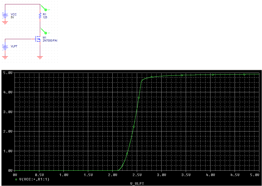

First, a mosfet is a much better choice than the op-amp here because it is much simpler, involves fewer components and calculations, and can handle much higher currents than an op-amp, like this (sorry not sure why I was on the op-amp kick):
Next, as for your relay, let's run the numbers. It's handy that it comes with a board, but a cheap protoboard like the pre-etched ones they sell at RadioShack will offer you a bit more flexibility at a cheaper price (Futurelec is even cheaper although the boards are large, SparkFun has this little guy which is the perfect size for your project although you'll want to check out this nice perfboard soldering tutorial). Secondly, that relay is physically much larger than what you'll actually need for this project. But, I digress. Anyways, the relay:

Great! Next step is to pick a MOSFET. You want an n-channel MOSFET. MOSFETs are a bit fuzzier with requirements. Your requirements are pretty easy:
- Minimum gate-source breakdown voltage: >= 10V (that'll let you run the gate off your 4.2V line + lots of padding).
- Minimum drain-source breakdown voltage: >= 18V (that'll let you run power to the +12V line if you want + lots of padding).
- Maximum drain current: >= 80mA (your relay coil is 40mA nominal, + some padding)
- Threshold voltage somewhere in the middle of your 0-4.2V signal e.g. 1-3V.
There are other considerations too so I'll just cut to the chase and say a common Fairchild 2N7000 mosfet will get the job done fine (and they're super cheap):
- https://www.mouser.com/ProductDetai...mdCx%2bAA2NB///eDBYfiAxm8hO%2bvIx3eNCzWH3m2A=
Next, resistor R1. You actually don't want this resistor if you're using VCC=5V. But I want to mention it because you'll have to include it if you use higher VCC to drop the voltage down to the relay coils nominal voltage. Recall the coil resistance is 120Ω and nominal voltage is 5V. V/R=I so 5V/120Ω≈42mA nominal current. Now let's say you have VCC=12V. You want the voltage drop across R1 to be 12-5=7 volts (to limit relay voltage drop to 5, also mosfet on resistance is small enough that we'll pretend it's 0 to simplify things, this doesn't need to be super precise). R=V/I so 7 volts / 42 mA = 166Ω so if you use a 12V source R1≈166Ω (166 is not a common resistor value, but 160 is and is fine) will be necessary to protect the relay.
In general you can simplify the above math to R1 = (VCC - 5) / 5 * 120.

This will give a clear picture of the mosfet switch, X-axis is mosfet Vgs (voltage from the data line of your parallel port) Y axis is voltage across relay. You're switching between X=0 and X=4.2 (over whatever the rise and fall time of your parallel port data line is). Note current beings to pass at Vgs(th)=2.1V which you can find on the data sheet, and the curve flattens out corresponding to the Vds≈5 saturation point which you can see in figure 1 of the datasheet.
