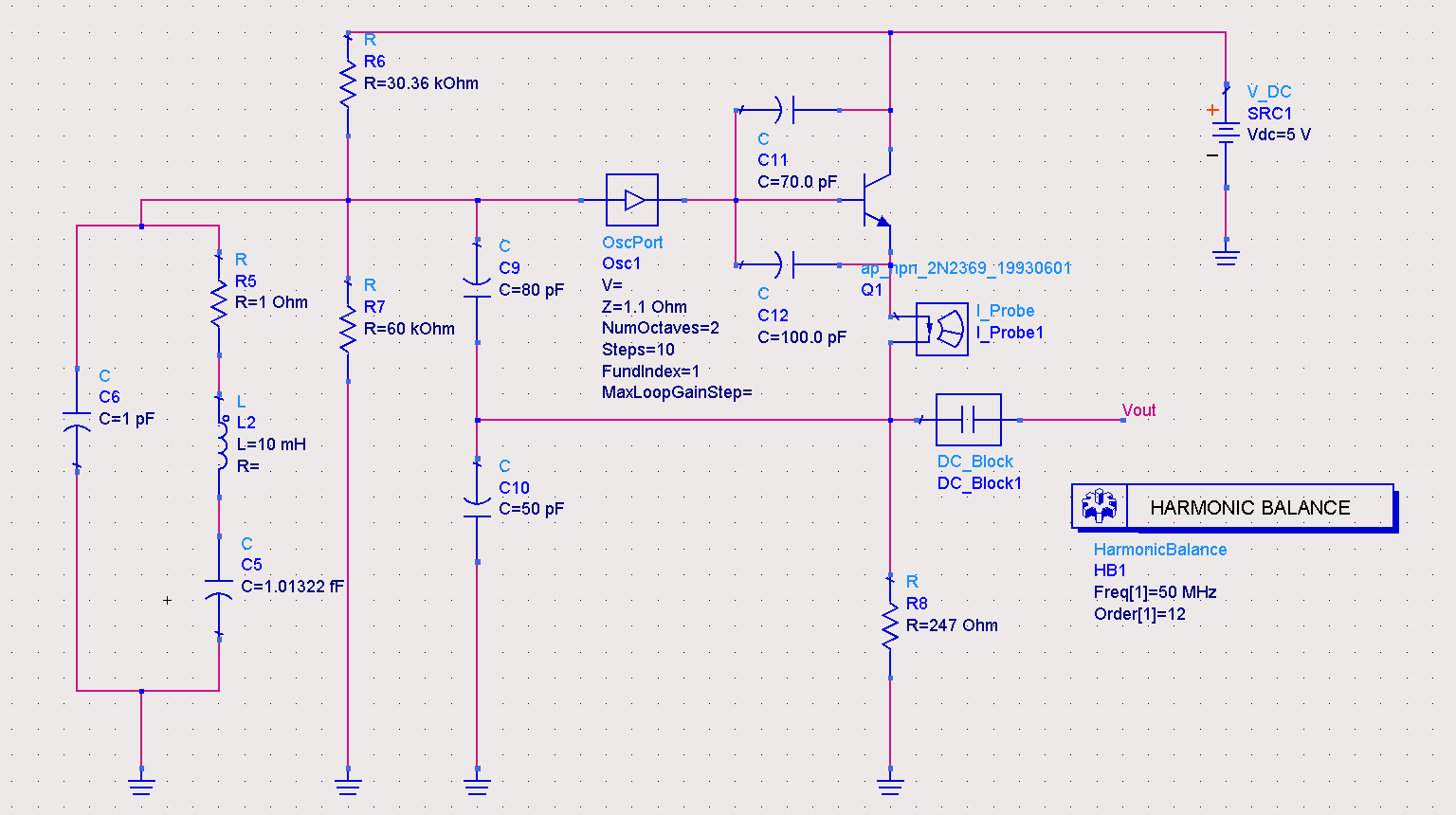

Hi there,
I designed a Pierce oscillator in ADS, working @ 50MHz. Now I want to try a frequency multiplication to have it at the 3rd or 5th overtone.
Now my question, where and what kind of LC-circuit do I have to place in my circuit for selecting an overtone?
Here`s my schematic...
Would be great if somebody could tell me what and where I have to place a LC-circuit, thanks.

There are two ways you can do this.
1) actual frequency multiplication, as you title implies. You would add on another circuit at the output of the oscillator that used diodes, transistors, fets, digital gates, etc to generate a X5 signal, and then follow that by a clean-up bandpass filter.
2) make a 5th overtone oscillator, and have the fundamental oscillator output frequency be 5 x the crystal resonant frequency. To do that, you need to model the crystal to be resonant at 5 x the frequency, which I do not see in your schematic. You model the crystal with only one L-C, where as you need another two at 3 x F0 and 5 x F0. Also you need to replace C6 with some L-C network so that the oscillator as a whole is not able to run at F0 or 3 x F0.
First, your oscillator is not a Pierce, is a Colpitts.
Second, referring to the initial question, in this crystal oscillator you can place in the collector of the transistor a parallel LC resonant circuit tuned on other harmonics.
On the other hand, looking to your schematic I don't understand the role of C11, and also C12 is in parallel with C9. The feedback capacitors are C9 and C10.
I think you have to remove from the circuit both, C11 and C12.
Thanks to you both, the parallel LC circuit worked fine on my example. The two capacitors C11 and C12 were just there for some finetuning in frequency, didn`t need them for real.

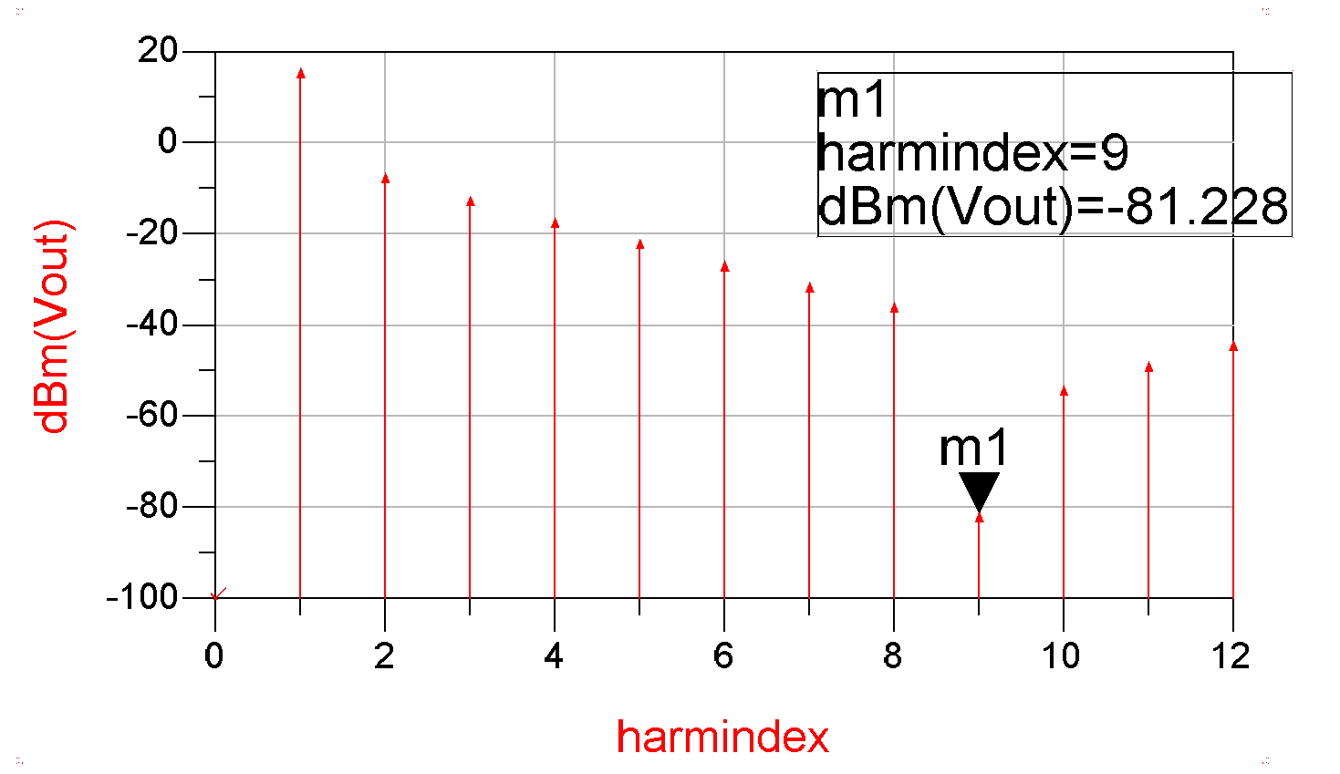

Mhh, okay... guess I know what you mean. But, if I tune my LC circuit to 450MHz (the ninth of the 50MHz quartz) - only my ninth overtone is rejected downwards, it works as a band reject filter.
I took a screenshot of the Harmonic Balance simulation and of the schematics.
You have to pick-up the signal from the collector, maybe using another inductor inductive coupled to L3.

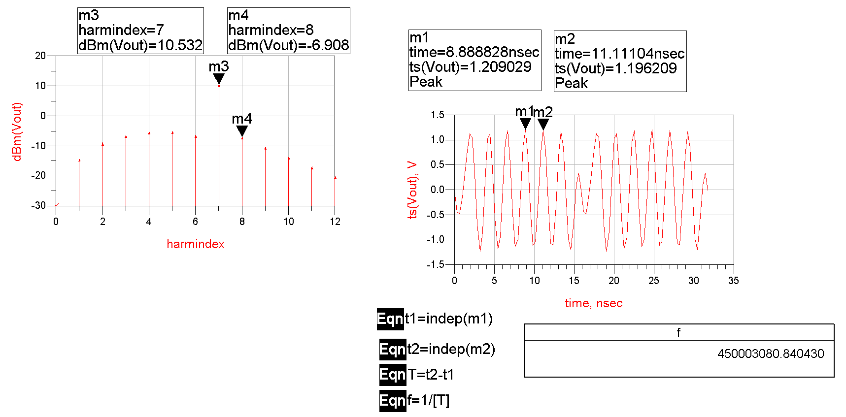

I just tested the method posted by vfone, and it worked. Not very good for the first time, but it was ok.
But the frequency wasn`t arround 450MHz... it was 416MHz. So I did some finetuning @ the quartz and the parallel LC-circuit and got the 450MHz.
But that tuning took me to the 7th overtone, as you can see in the picture below. And somehow I should try to get a better sinus, `cause that`s not what I want to have
at the output... ^^
And shashy.br - thanks for your hints, but I shouldn`t use diodes or something like that for multiplication. This work shall be done with only overtone-quartz and LC-circuits...
Doing this kind of harmonic generation using just one active device is tricky. Because you have to do a compromise, first to have a distorted signal rich in harmonics, and second, the selected harmonic to be a sinus as clean as possible. Just adding more filtering at the output it will clean the desired signal.
