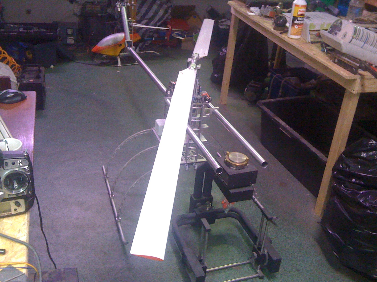

User “bulbonick” presents his youngest kid - "HELICAM".
The assumptions were as follows:
3-axis gyro stabilized head weight: about 5kg max
Camera weight up to 9kg RED ONE 5kg with the optical appliances

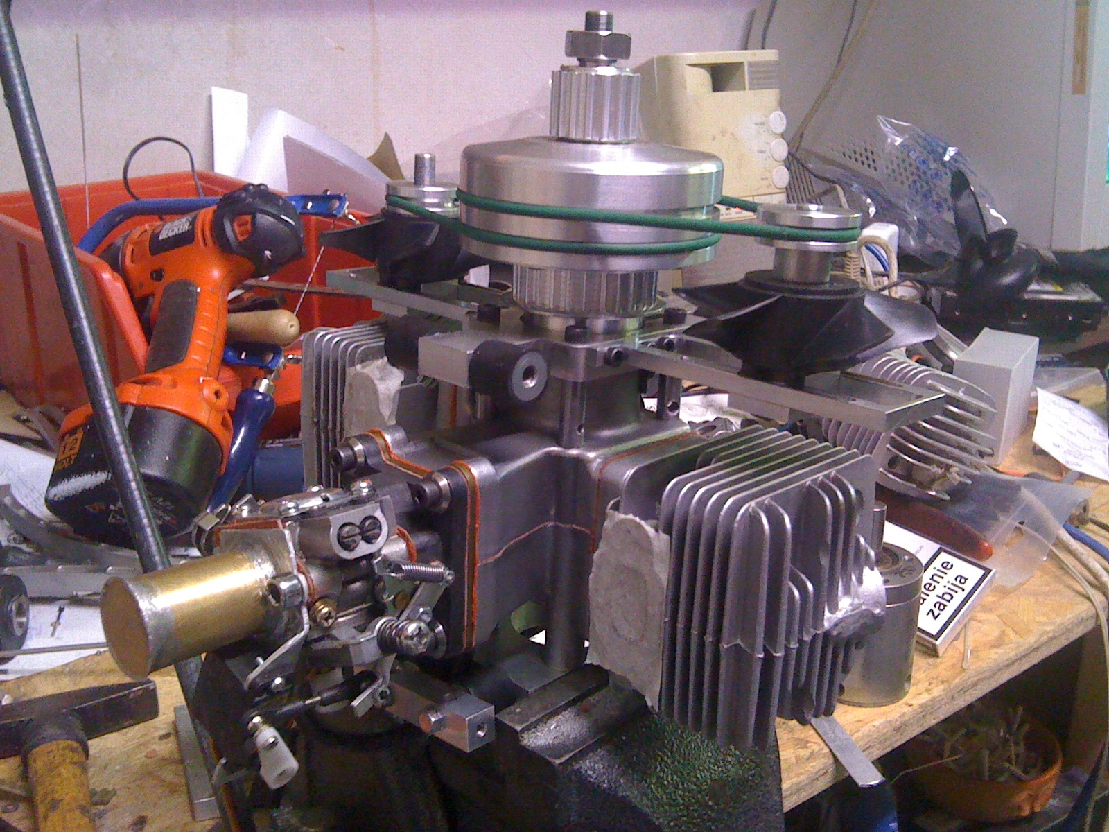

That’s why the Helicam had to be big and so it was. It is powered by a 50ccm 4,7KM boxer engine with 6500RPM

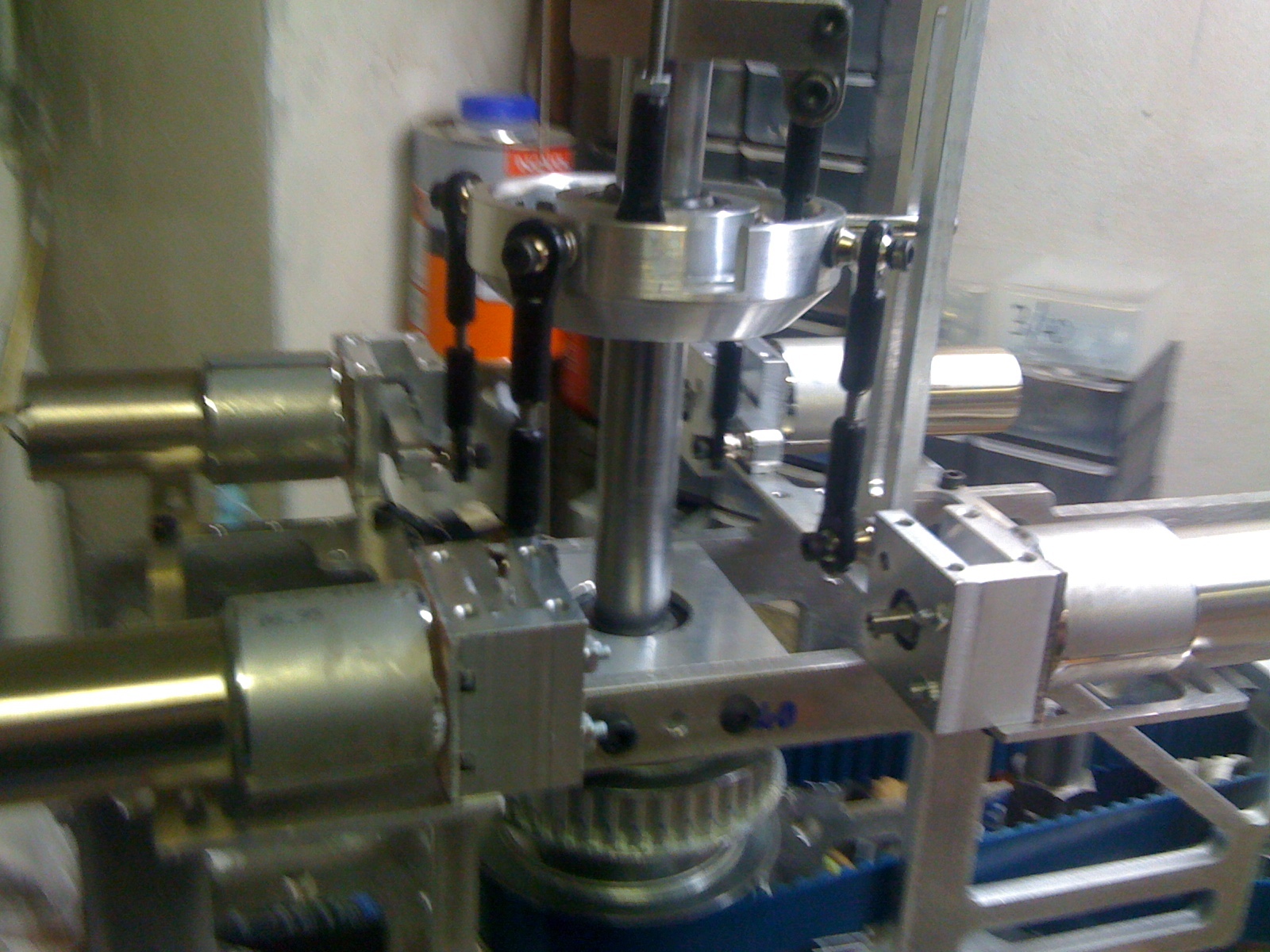

2500mm two-shovel main rotor, flybarless that’s why the stabilization system Helicommand Rigid was used, controlling disk supported at 4 points 90+45°
