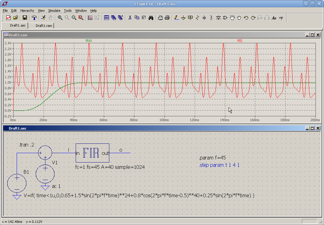

Just a quick intermezzo to actually show what I want and to show you a few results.

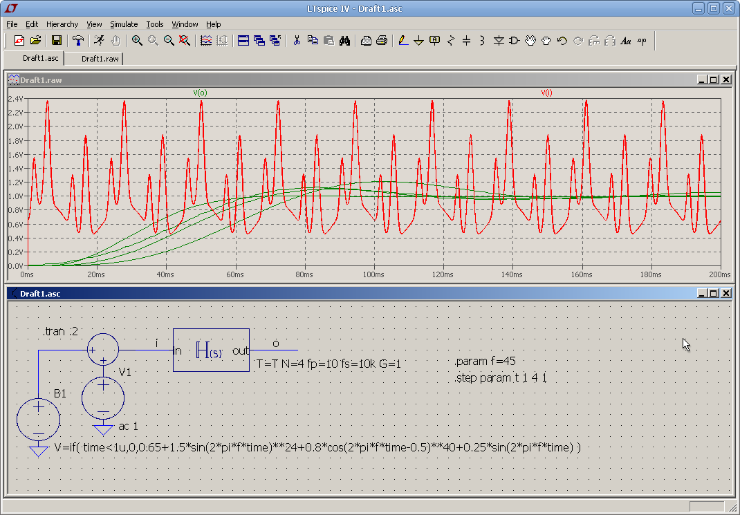

Screenshot01, which shows the kind of signal that may be at the input and the responses from an analog filter with fc=10Hz, N=4 and four different types (from first to last): Bessel, Chebyshev II, Butterworth, Chebyshev I. Butterworth and Chebyshev II are similar and both have settling time at ~110ms, Chebyshev I still oscillates until ~140ms, Bessel only at ~60ms.
Screenshot02 shows an FIR at work with, as seen, fc=1Hz, fs(top)=45Hz, Att=-40dB, sample=1024Hz (M=62 [edit]M=60, sorry, I looked at Maxima instead[/edit] ). You can see it setles at ~40ms, a winner so far but it still takes more than 2 periods of the input (f=45Hz, worse case). Also notice the extracted DC level...

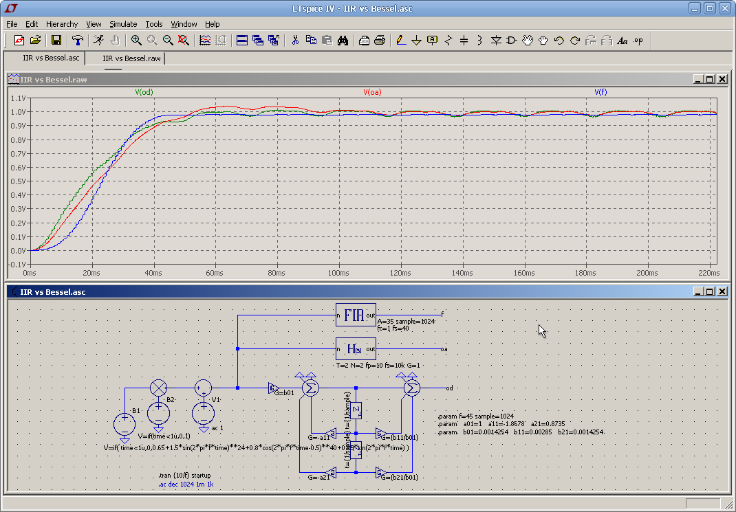

And lastly, Screenshot03 which shows three fillters, side-by-side (up to down):
1) FIR with fc=1Hz, fs(top)=40Hz, Att=-35dB (a minimum), sample=1024Hz [edit2]M=50, forgot this[/edit2]
2) Analog Butterworth with fc=10Hz, N=2
3) IIR Bessel, same settings as the 2nd (chosing Butterworth would have resulted in a same, more aliased result as the analog one)
The shown examples as well as your comments are partly clarifying the specification.
I think, some confusion is caused by the unrealistic FIR specification of fc=1, fs=40. If you check the actual frequency response, you'll notice a (-3 dB) cut-off frequency of about 15 Hz, which is set by the limited number of FIR taps. I also understand, that something similar to the Kaiser window, N=40 FIR is a good choice in your eyes.
If you prefer an (almost) monotonic time domain response, Bessel (or even a lower Q Gauss type) are the ownly analog filter prototypes of interest. With a moderate order like 3 to 5, you get a time and frequency domain response that's nearer to your FIR. The FIR however creates additional comb filter zeros under the given conditions, that can't be provided by an IIR.
P.S.: My conclusion is, that the FIR is most likely better, if the interfering signal is 50 Hz fixed frequency and you can utilize the comb filter effect. If you however expect a range of e.g. 40 to 60 Hz, it's not necessarily better. So the problem once more refers to fixing the specification.
