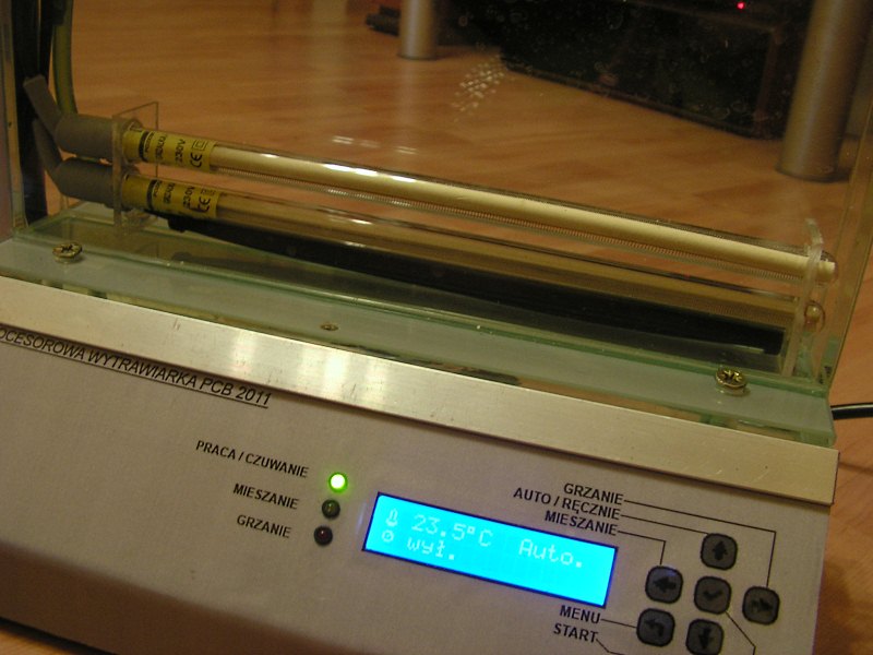

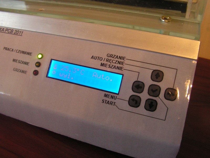

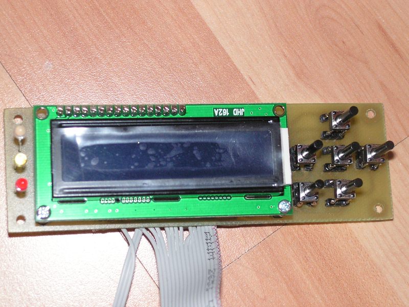

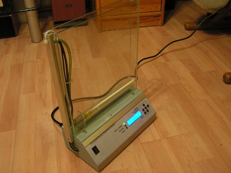

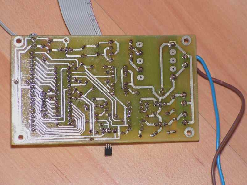

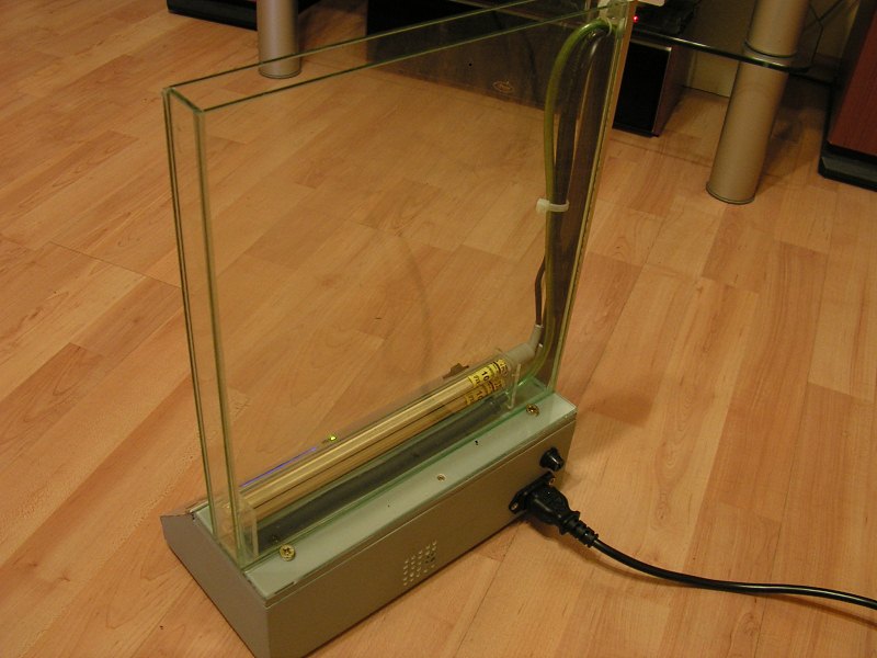

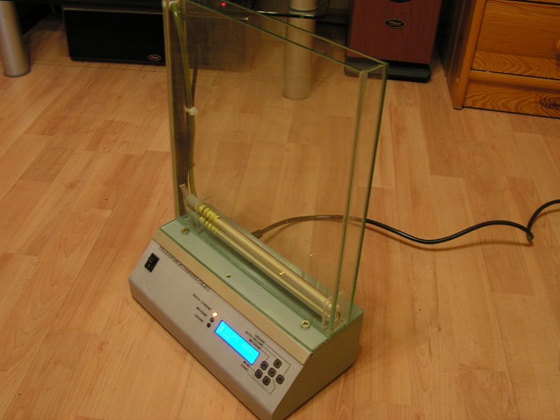

Processor etching tank
The second etching tank is based on another driver. The housing is glued from foamed PVC spatuled and painted with a shower. The aquarium dimensions are 27x31cm, so bigger boards can be etched. The heaters are 2x100W, which is enough to quite rapid heating up the solution (over a dozen minutes).

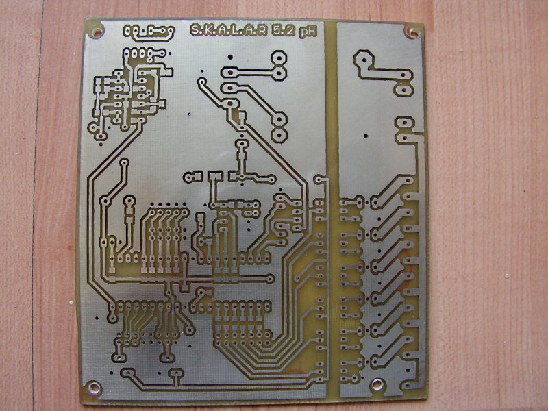

A board etched in the second etching tank (thermal transfer and tin plating).
