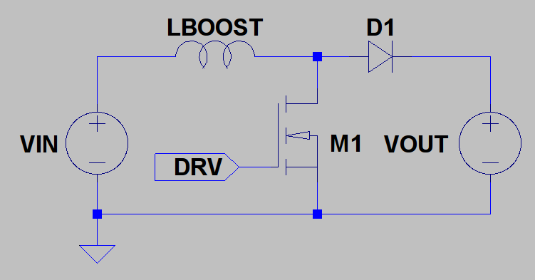

Let's say you have a boost converter operating with continuous inductor current. This might not be the most efficient or correct way of analysis things but it does show some of the salient points. The power stage is,
Operating Duty Cycle, Continuous Inductor Current
During switch on time, TON, the inductor is set through VIN. During switch off time, TOFF, it is reset through [VOUT - VIN]. The change in current through the device during each phase is,
dIset = TON.VIN/L
dIrset = TOFF.[VOUT - VIN]/L
Steady state with continuous inductor current the average does not change so,
dIset = dIrset
and therefore,
TON.VIN/L = TOFF.[VOUT - VIN]/L
Cancel L,
TON.VIN = TOFF.[VOUT - VIN]
Normalise to one second and TON becomes the operating duty cycle, D, with TOFF becoming [1 - D]. Substitute,
D.VIN = [1 - D].[VOUT - VIN]
Multiply out,
D.VIN = VOUT - VIN - D.VOUT + D.VIN
Rearrange a bit,
VOUT - VIN = D.VOUT
And a bit more,
D = [VOUT - VIN]/VOUT
It is the operating duty cycle for a boost converter with continuous inductor current.

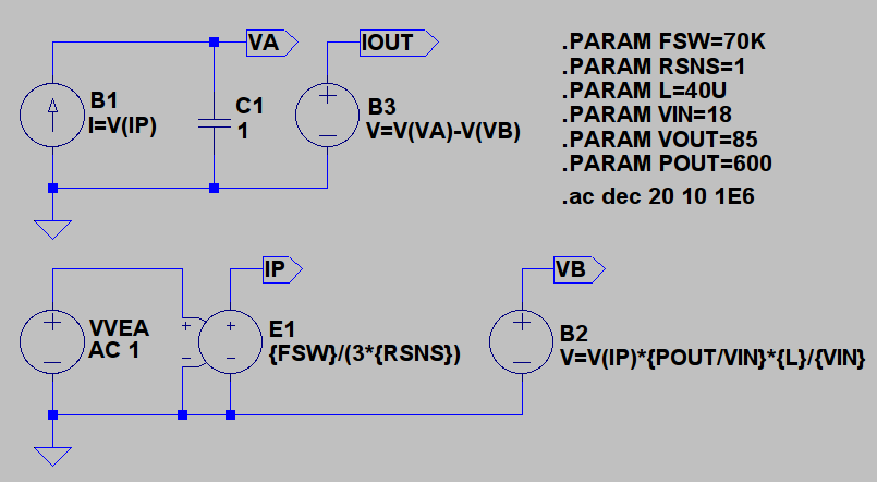

Time for more,
dIOUT/dVvea = Fsw/3RSNS . [-j/2pi.f - L.IL/VIN]
Can be modelled in LTSpice as,
VVEA is going to be the output of the UC384X error amplifier and is applied to a voltage controlled voltage source with gain set to Fsw/3RSNS. The result is used by B1 and B2 to create the terms in [] above. C1 driven by B1 as a current source gives -j/2pi.f and B2 implements the second term. B3 does the final sum to get the output current.
There is a table of parameters top right which should explain themselves. IL in B2 is calculated as POUT/VIN..

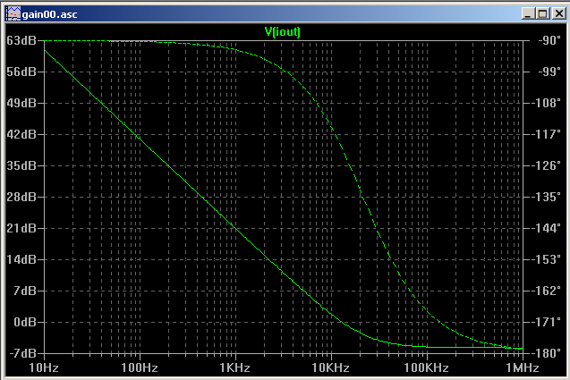

Running an AC analysis gives,
We get the expected 20dB/Decade roll-off with 90 degrees phase lag and then the zero.... but instead of the phase returning to zero itself it goes the other way resulting in an overall 180 degrees phase lag. It is the Right Half Plane Zero... RHPZ and, in analog terms, is something you can do little to nothing about other than avoid it.
In this case it is sitting at about 2.1KHz which is 'low' but then we are dealing with a high power circuit and steady state current in the inductor is large. This is actually taken from another thread where someone else may be having loop compensation problems so I thought I'd kind of combine the two. That might not be board etiquette but...

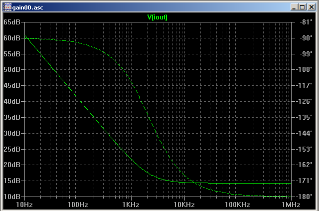

The above is set to 'worse' case. Maximum power with Minimum input voltage. The other possible operating points of interest might be,
Maximum Power Maximum Input Voltage,
Low Power [60W vs 600W] Maximum Input Voltage,
Low Power [60W vs 600w] Minimum Input Voltage,
In all cases the RHPZ moves out to higher frequencies and therefore becomes less of a concern. You would still have to design for the minimum. The other converter is required to give 600W out from a minimum input voltage of 18V. Some people are just hard.

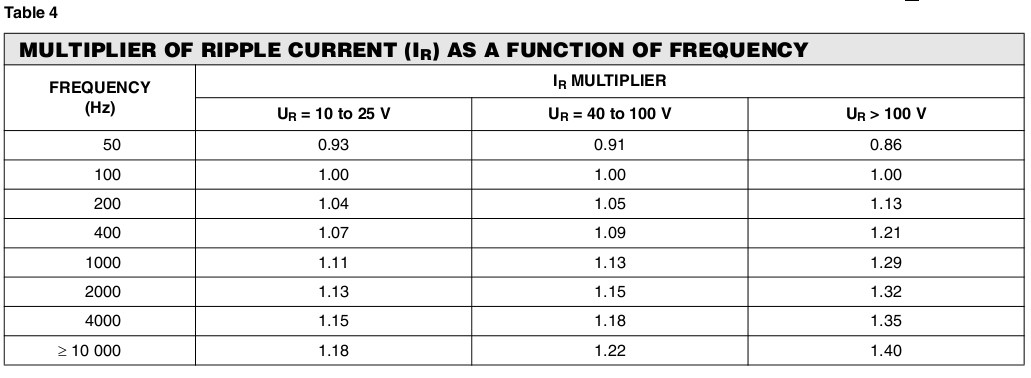

The output capacitor for such a beast is going to suffer from high ripple currents. It is not as if the rest of the circuit won't be carrying heavy currents either. I have a 'basic' switching model set up for it that says the RMS ripple current is 13.75A so I'll go and hunt for a capacitor that might like that.
This won't be right...

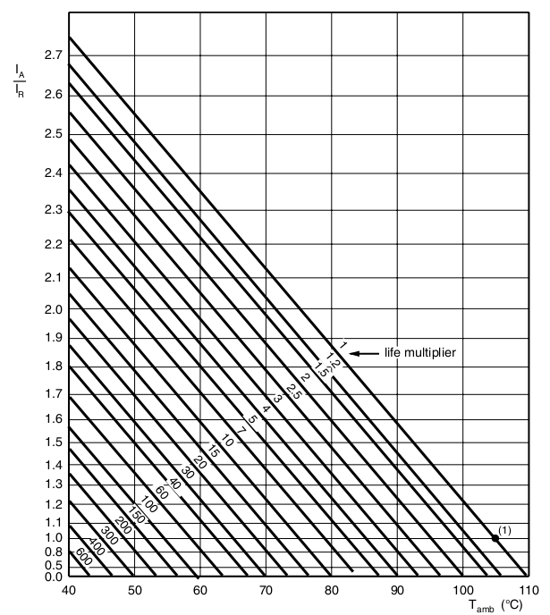

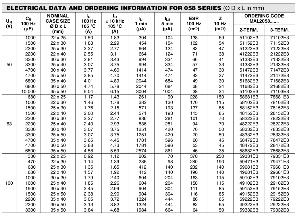

https://www.farnell.com/datasheets/415501.pdf
Table 4] Page 9)
100V Frequency multiplier for ripple current 1.22 That brings things down to 11.27A. Let's say the product will be in continuous use for 2 years at 60C ambient. 17,520 hours. Indicated stress life, 105C/MaxIr, is 5000Hrs so I am looking for a lifetime multiplier at 60C of 3.5,
That lets me increase the rated ripple current by a factor of 1.9 so we are down to 5.93A...
And I shall pick two 1500uF 30x40 59152E3. I think that the way the tabels have been labelled may be in error. Impedance > 10KHz is 85mR. Of course such values are subject to variations. Anyway, so that will be 3000uF bulk capacitance with an ESR of 43mR and we can slap that in the linear model...

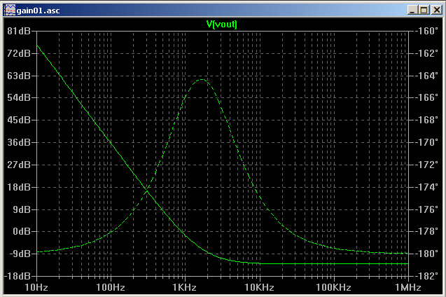

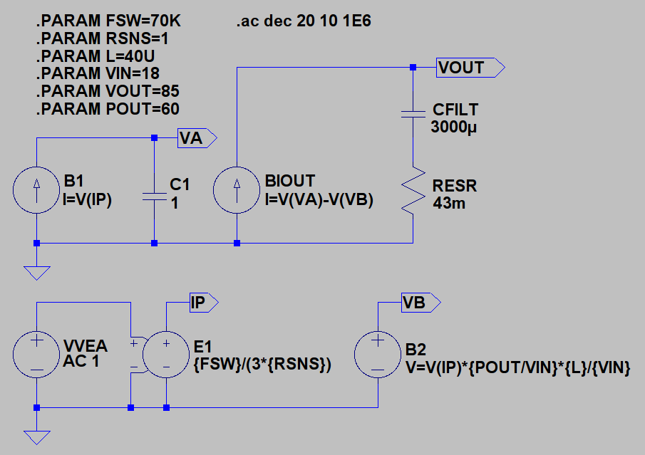

I have converted B3 to a current source as BIOUT to drive the filter capacitor and its ESR with the result being VOUT...
Setting 18V in and 600W out then running the AC analysis gives,
As expected a current source with a first order characteristic driving a capacitor becomes overall second order and down at low frequencies we get a slope of -40dB/Decade and a -180 degree phase shift. The ESR zero in the capacitor is at 1/2piCfiltResr or 1.23KHz so we might hope that the system would return to first order with a 90 degree phase lag.
It doesn't, although it tries, because the RHPZ wakes up in the same frequency range, 2.1KHz with two zeroes cancelling the two poles, taking the system first order, flat, and kills off the phase recovery of the ESR zero to hold things down at a -180 degree phase shift. :-(
