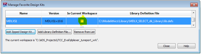

I downloaded the modelthics SELECT v11.0 for ADS-windows(84mB) and installed it my system of 32bit pentium 5 processor, operating system of windows 7 ultimate,3GB RAM.
I am using ADS2011_10 , installed it on the C drive.Where I can find these library and how to get it appear in the ADS 2011_10 library.
Any Design Kit/Library has to be enabled separately for each workspace were you wish to use the parts. Just installing the PDK/Library on the system is not sufficient to use the parts in ADS.
With a workspace open open Files > Magage Libraries... and select the Add Library Definition File... button and browse to and select the lib.defs file in the Modelithics SELECT Library. Once you have added this library it should be available in the Read-Only Libraries sections in the Library View tab of the ADS main window or the ADS Component Library browser window.
