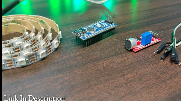

You Will Need Some Componenets For Make This Project
Parts list (): -
Arduino UNO - https://amzn.to/3fljESD
Arduino Nano - **broken link removed**
RGB strip LED :- https://amzn.to/3gXEAPZ
Sound Sensor :- https://amzn.to/38VsO5K
Jumper Cable - **broken link removed**
Componenets :-
All Componenets

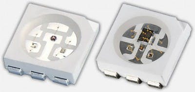

The WS2812 however is a WS2811 placed inside a 5050 LED package.
The 5050 LED is a very common 3 LED (Red, Green, Blue) package, in one 5mm x 5mm case.
A WS2812 is the same package but with an additional WS2811 LED driver IC on board.
In the illustration below you’ll see the difference:
On the left a 5050 RGB LED, on the right a WS2812 which combines a 5050 RGB LED with a WS2811 controller.
Note how the layout of the “silver” tracks are almost identical in both images, yet the black (IC) block and the tiny wires are different (right).
5050 RGB LED (left) and WS2812 (right)

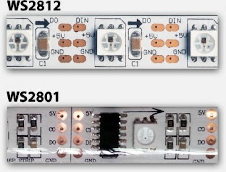

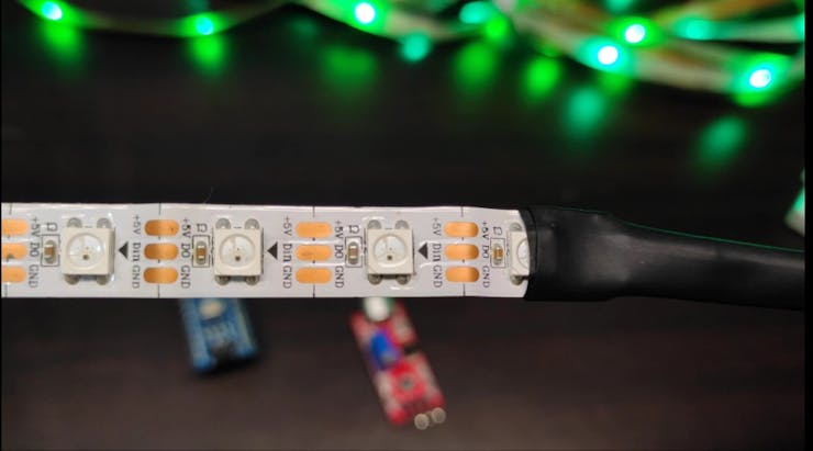

DIGITAL RGB LED strips
The digital strips are the ones we will use in this project.
In particular: we will use the WS2812 in our project.
The cool part of a digital strip is that you address each LED individually, making very cool effects easy. Obviously the kind we’d like to use in our projects.
In the illustration below you can see the physical differences between the WS2801 and the WS2811/WS2812 strips.
Unlike the analog strips: Most Digital RGB strips operate on 5 Volts!
Note:
- Not all strips of the same “model”, look the same, but have typically a very similar layout.
- strips can be sold as a white or a black strip (background strip).
- Notice the arrows indicating Data direction.
- WS2801 has 4 pins, where as the WS2811/WS2812 only has 3 pins.
- There are digital strips that look like WS2801/WS2811/WS2812 strip, that are NOT based on any of these LED drivers.
- Strips can be had in waterproof (in plastic “tube”) or for indoor use only.
Digital LED strip – WS2812 (top) and WS2801 (bottom)
WS2801 vs WS2812 pins

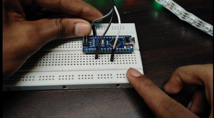

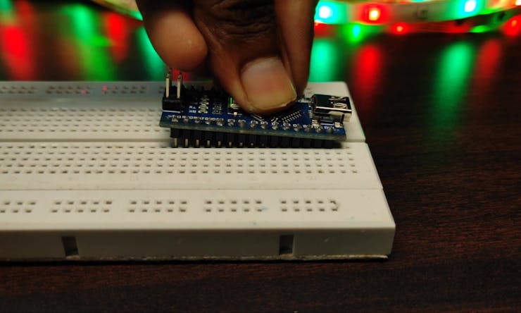

Fix Arduino In Breadboard
Connect Strip Light with arduino

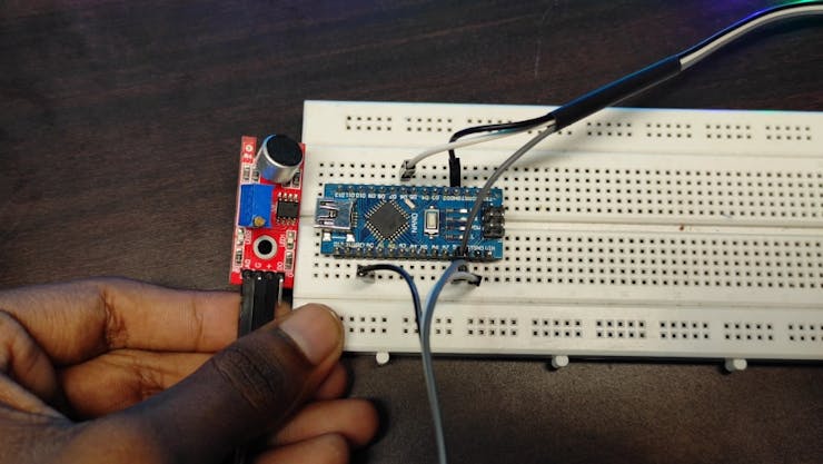

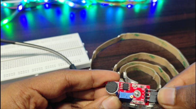

Connect Jumper Cable With sound Sensor
Connect Sound sensor With Arduino Nano

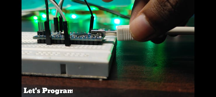

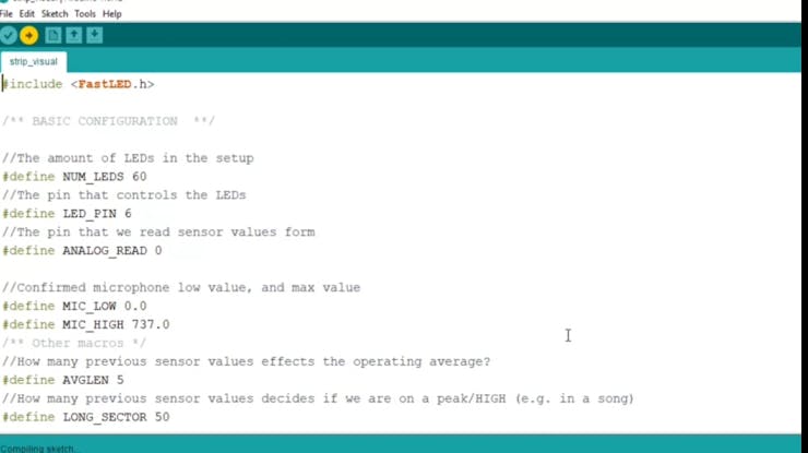

Upload Code In Arduino Nano
Upload The Code
