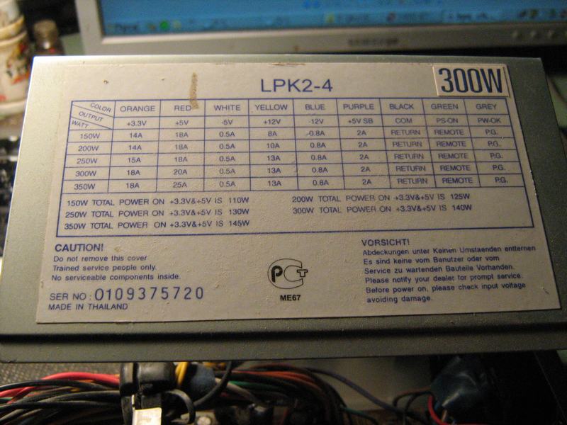

I think I have settled on a starting point and that is to buy a computer power supply that is around 300-500w and has an Energy Star rating of some level. As you said, it will offer me many of the standard voltages I would come across in my projects. The only thing it doesn't offer is variable control or voltages over 12v @ >2A.
The biggest question then boils down to how cost effective is it to turn the 12v rail in the psu into a variable output with a much higher max voltage and maintains at least 75% of the power originally available on that rail? For example, if the rail is rated for 20 amps and the max voltage for the variable output was 48v, then that variable output should be capable of 3.75A< output current < 5A. What about for the 5v rail? I'm asking about that one because I've seen a lot of the 5v rails have similar power ratings as the 12v rails.
The other stuff seems like it would be fairly easy to add in such as voltage, current, power, temperature meters. Also an adjustable current limiter and a switch selector to set what voltage is at the output terminals.
Down the road, I'm assuming it wouldn't be that difficult to modify the psu to bypass the AC stuff and provide an input for 12VDC from the car.
So at this point I am trying to find a way to convert the 12v and 5v rails from a computer psu to provide higher voltage yet maintain a decent amount of the rails rated power. If you have any ideas please let me know, so far the only IC's I've found might get me up to 36v @ 3A which is decent but I'm hoping for a bit more. Considering that the sole reason for higher power output is to test drive a cnc spindle, would it be possible to run 3 of the boost converters off of the same rail so that I could have one boost circuit per phase winding? At any rate, the biggest thing on my mind is how to increase the current and the voltage beyond what a standard boost IC can do, at least the ones from National. Thanks again.

For a PC power supply: forget that. Either put a car battery -> AC inverter in between (unnecessary complicated, and wasteful if the goal is to produce low voltage DC from a car battery), or reserve PC psu for situations where you can use mains AC.

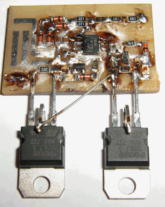

You're making the thinking error that IC itself should handle the voltage / current directly. For low-power applications that's the usual setup as it minimizes external component count.
But there's many power conversion IC's that can control external components (for example a high-voltage, high-current FET) to do the heavy lifting. That FET would see the high voltages & currents, but the control IC would only output an on/off signal, and use some kind of feedback (for example output voltage put through a resistor divider, or signal from an optocoupler) to see what's happening.
There's 1001 ways to do that, hence my suggestion of "look for circuit in similar application".

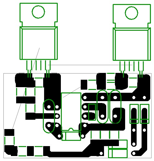

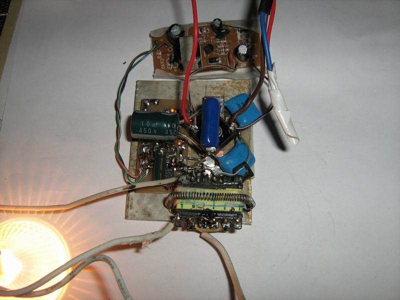

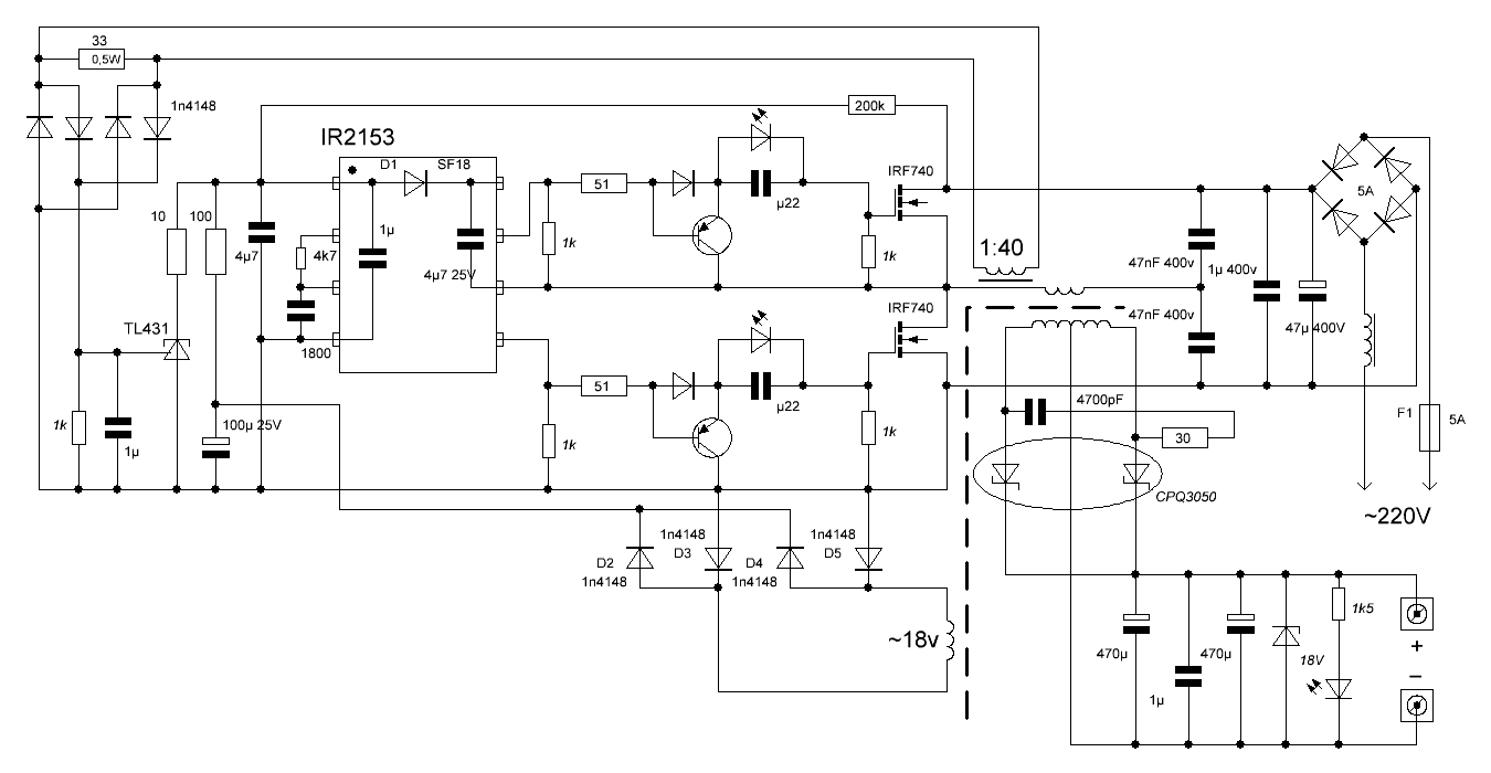

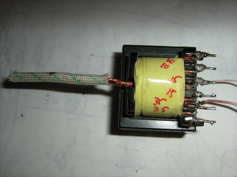

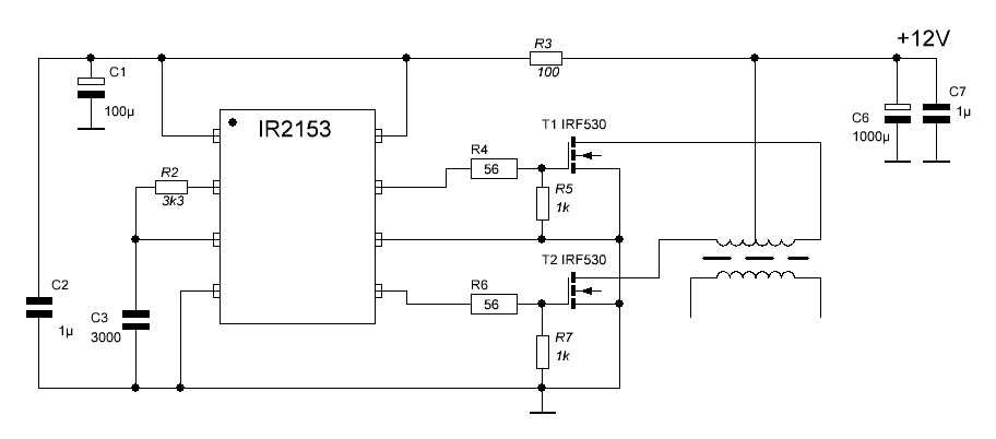

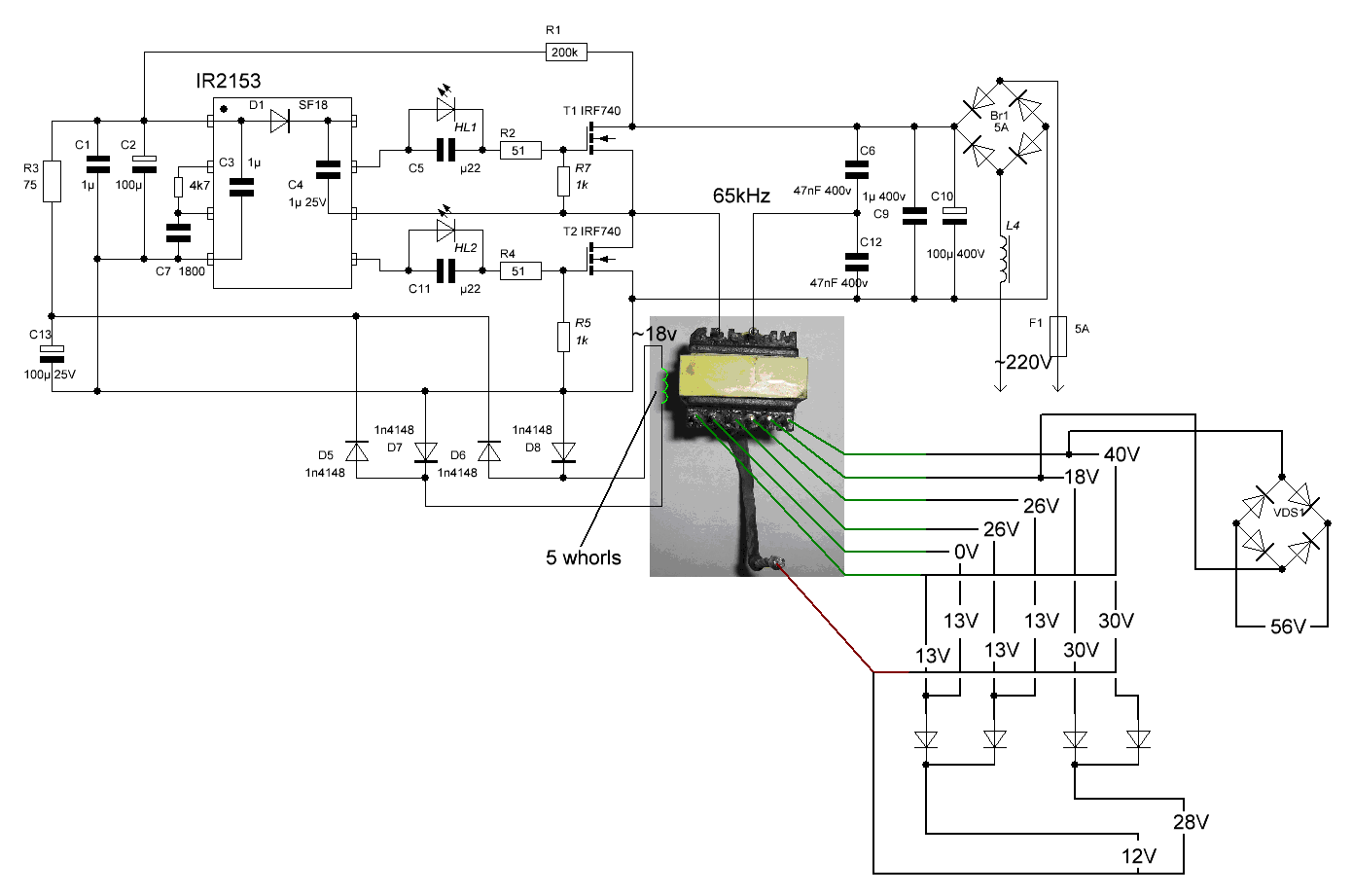

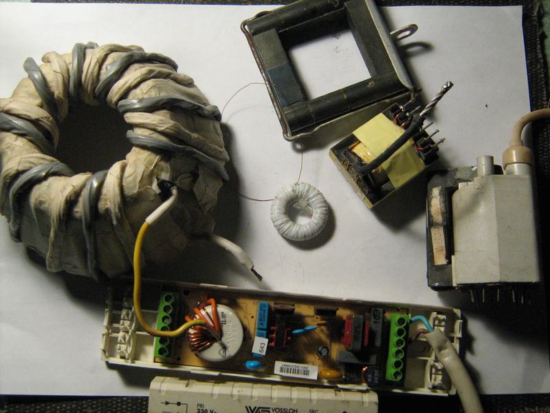

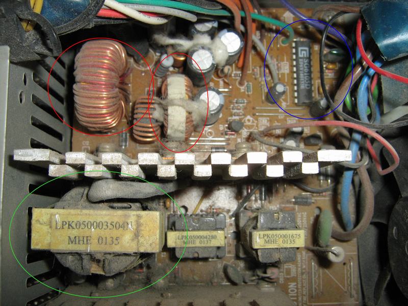

It is possible extract some different voltages from transformer taken from PS power supply, without additional transformations.
This transformer also possible to use up-down, secondary coils as primary.
However not all computer power supply unit are made on half-bridge scheme and accordingly not all their transformers are fit for such connections.

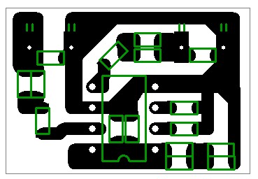

But it is easy to wind its on any approaching on size ferrite core, due to that half-bridge schematics do not require selecting the clearance in core and not so sensitive to correctness of winding.
PCB possible slice by means of linen saw on metal for five minutes, without any of the chemistries ).
Unlike converters on sine wave, square wave converters without PWM not change voltage under load
in such big degree and possible not to use stabilization that simplifies filtering the unbent current.
However in the case when is required regulation of the voltage, quite well using converters on cheap and broadly wide-spread MC34063 microcircuit.

One thing I think might work would be to use a 4 channel class D amp in the 400-500w range when it comes time to power the spindle motor. Assuming the 12v rail on the psu can provide the power for the amp then this should work if I can control the input signal to the amp. This will probably be very similar to controlling the spindle motor when the time comes.
Am I correct in thinking that an amp such as a car audio amp, are more or less high powered buck/boost voltage regulators? What I don't get is how they boost the voltage and the current beyond the IC's I've looked at. A transistor can output a voltage equal to or less than it's source voltage, dependent upon it's signal at the gate if I understand correctly. If this is the case, how do we convert the source voltage to a higher voltage using components that can handle the increased current that will come with it? I'll read up on that stuff some more.
If I were to build one from scratch, I think I would design everything off of a 12VDC source. Basically a DC input regulator feeding a multi-channel class D amp which should give me variable voltage well above the input voltage and be individually controllable on each channel. If I'm in the van, then I can just plug it in. If I'm using 120VAC, I would need to convert it to 12VDC. I think my focus should be on the amplifier design, the DC input regulator circuit I'm guessing shouldn't be too hard. As for being inside with 120VAC right now, I could just use a psu to power the amp. Instead of the $50+ psu's I was looking at, I could probably get away with a $35 one.
So to try and stick with finding something that is already what I need, I think that a class D amp with a 12v regulated input and a psu 12v rail circuit would work.

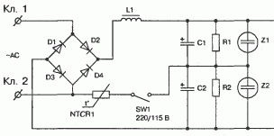

In PC PS at input 120V usually use schematics with doubler of the voltage.
apropos, there is opinion that schematics of PS with PWM does not be fit for HQ audio in view of high level of the hindrances.
