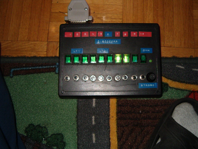

Assumptions:

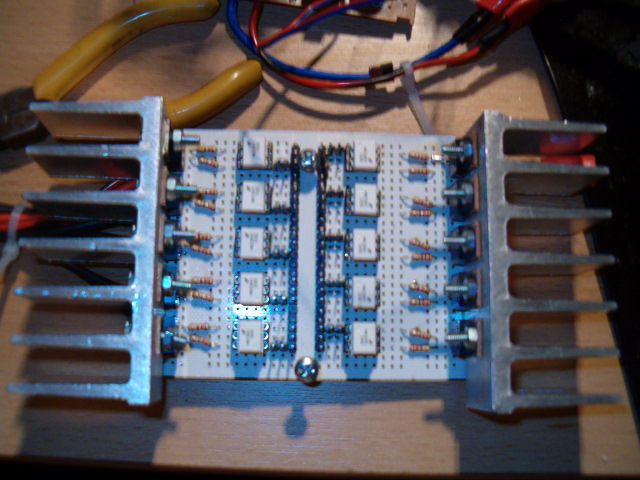

Support for 10 devices including smoke generator and stroboscope frequency; noise generated during switching illumination audible in speakers should not be generated; controller galvanic separation from mains is necessary (12V supply).
Design:
There were no real product design. I take advantage of discolitez controller, remaining were cables. Ryszard49, thanks for help with the power stages launch. Multilight, thanks for help with finishing jobs.
Build:

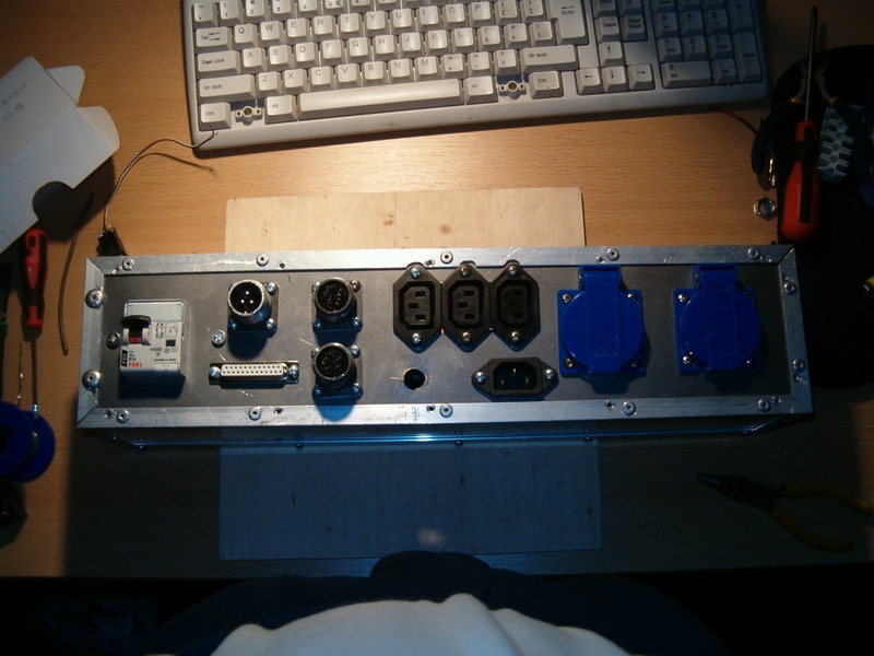

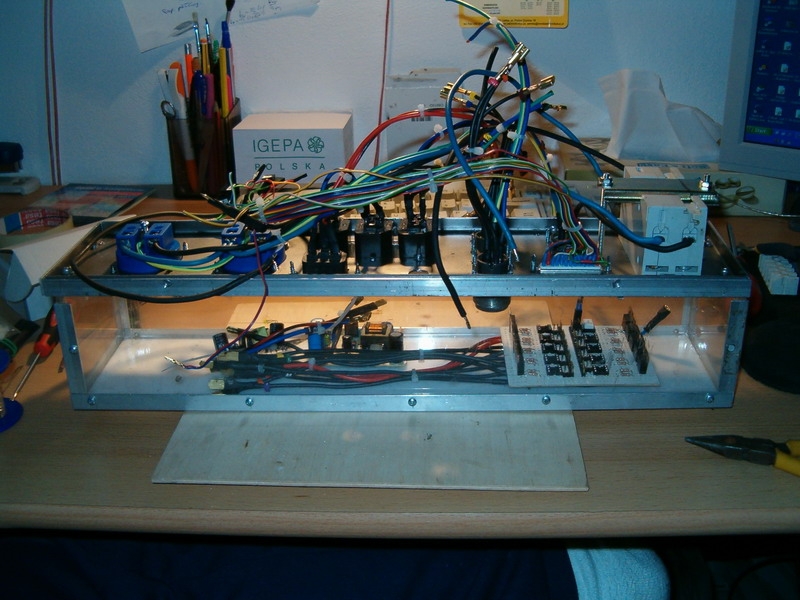

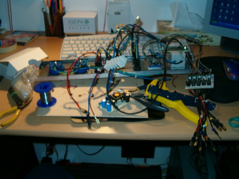

The case was taken from previous relay controller. It was made from perspex and aluminum angle bar, upper panel was changed to 1.5mm metal plate. Device consists of 10 identical modules with BT139 and MOC3041 (switching in zero).
Cost of device: 500 PLN (including 300 PLN cables cost).
Summary:

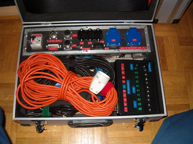

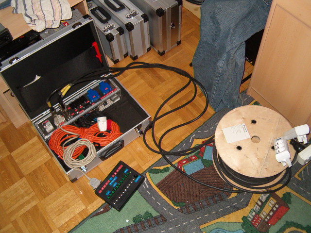

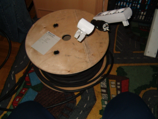

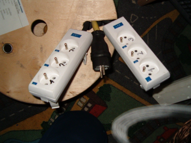

First socket is for connecting power with 15 m cable 3x2.5mm; next two sockets are for 12 m cables each supports 3 lights.
Three computer sockets are for future use, e.g. For additional lights. Next there is a socket for smoke generator. Smoke generator is switched by triac and is equipped with LED indicating readiness. Two mains socket are for general use: amplifier, computer, etc.Big jack socket is for strobe speed regulation. There is no generator, only common potentiometer 1 Mohm because stroboscope is modified. Last socket is for connecting panel with switches.
