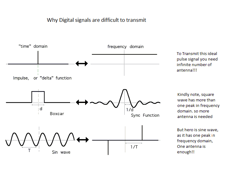

Yep Digital signal can be transmitted if you used one of the Digital modulation technique
see the image below
also visit thislink in order to get better understanding .
If you put more concentration you will find in actual analog transmission is only possible:smile:
further more according to Fourier ,square wave /Digital signal
contain infinite # of Harmoins of Fundamental frequency.
and I think you are confiusing yourself in this case

Hi Baranidaran,
To understand this easily, we have to think in frequency domain.
Assume we are having 100khz sine wave ---- in frequency domain you will get one single peak at 100khz. one antenna is enough to transmit this signal.
But take the square wave of same frequency ---- in frequency domain, it has number of values.
So to transmit digital signals your antenna has to resonate at wide range of frequencies to faithfully reconstruct the signals.
This is due to the fact that " square wave is made up of continuously changing sine and cosine wave forms".
Researches are going on Ultra wide band antennas to help in transmission of pulses and digital signals
Hope this helps...
