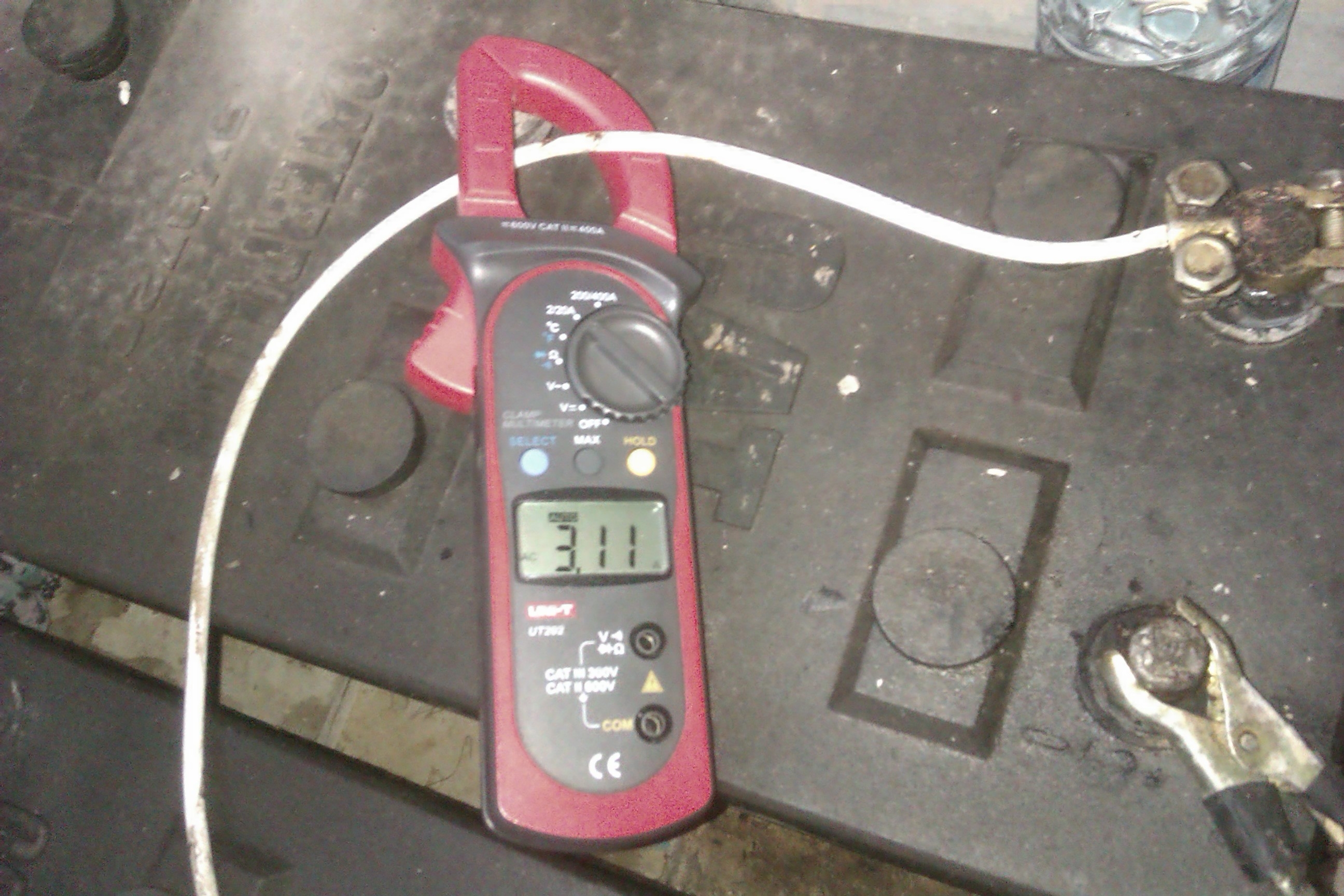

Nop it's not ripple current as well as not in milli amps it is considerable amount of current that is possibily correct,I checked the current of batties that is connected to the ups and it shows the charging current about 3.11A and you can clearly shows in the pictures that the meter can only measure for AC current.Please look at these pictures

A standard AC current clamp meter doesn't measure DC current. AC/DC clamp meters have separate AC and DC ranges.
I guess you are measuring a pulsating DC current, e.g. the output current of an unfiltered power supply. In this case you'll see the AC current ripple. It's related to the DC current but considerably smaller.

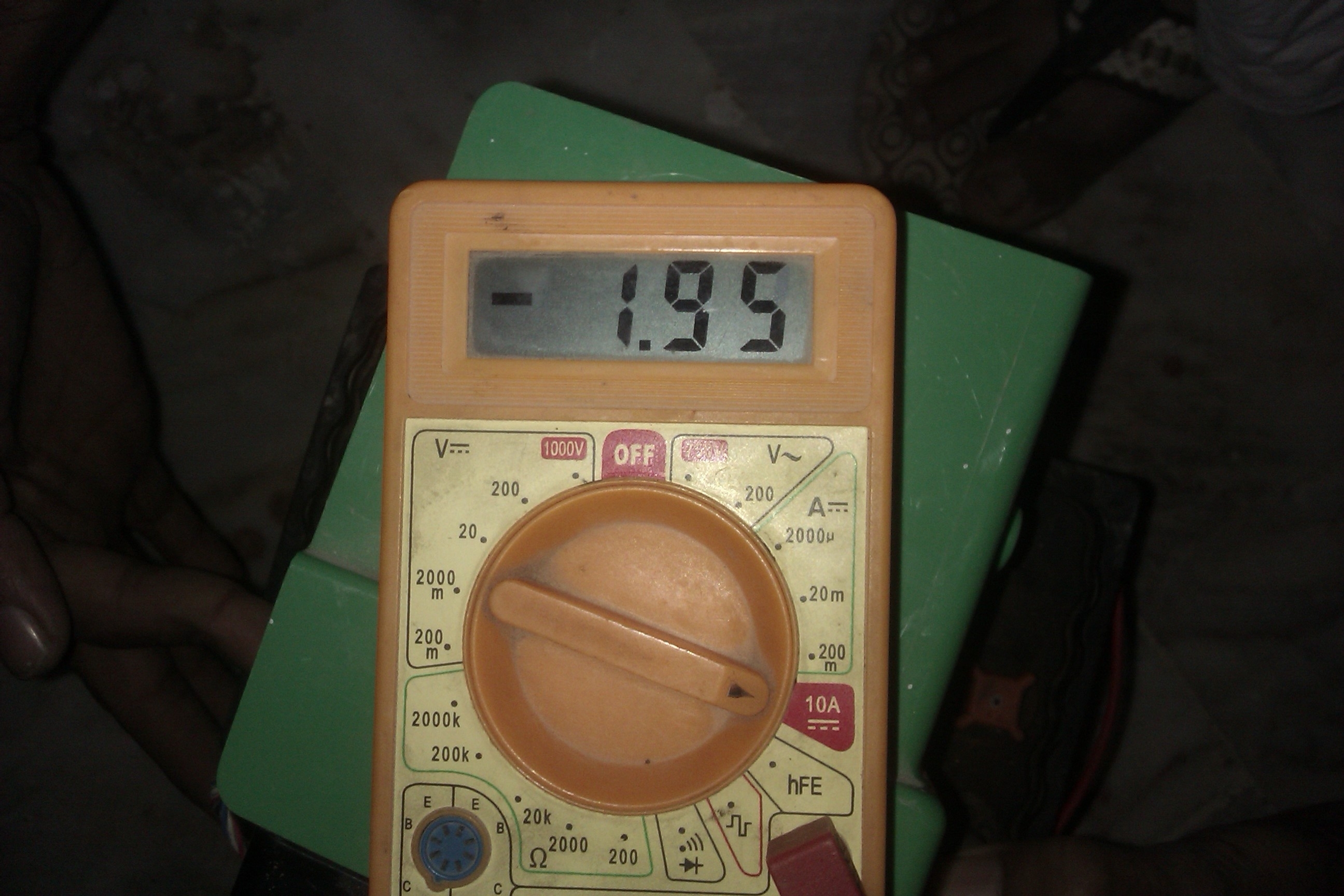

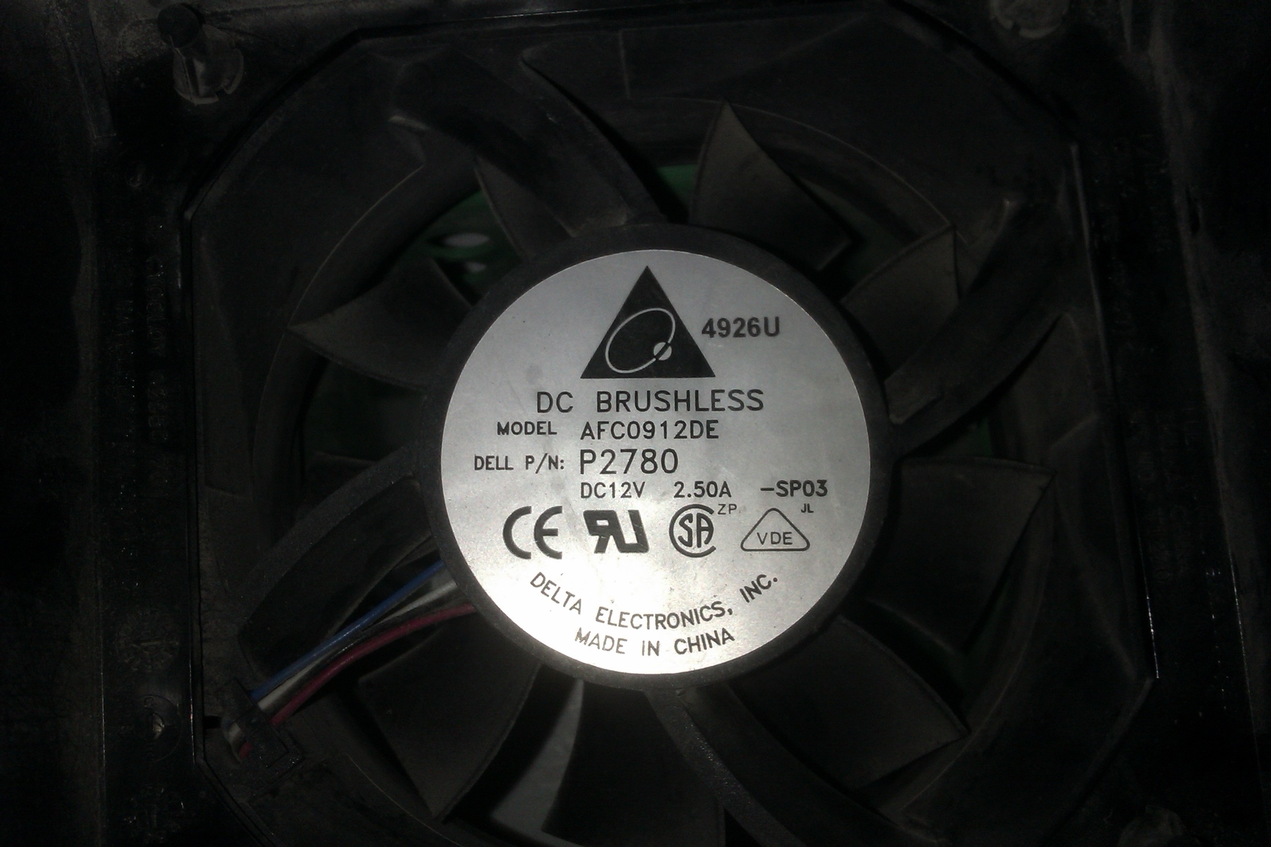

of cource it's a ups and the charging current is in the form of pulsating so that it charge the battery.Now I hold up a DC burshless fan from Pc rated 12V@2.5Amps directly attached to the battery terminals and using clamp meter in order to measure current so at this time it just shows .335Amps (thank you dhananjoykarmakar as you said it is small amount)
and when i used another meter (a very cheap one) but can measure the DC current I shows 1.95Amps (and ya I know it is very unreliable).but it show some how close to the acutal rating.These are the snaps :) and thank you guys for your help.
