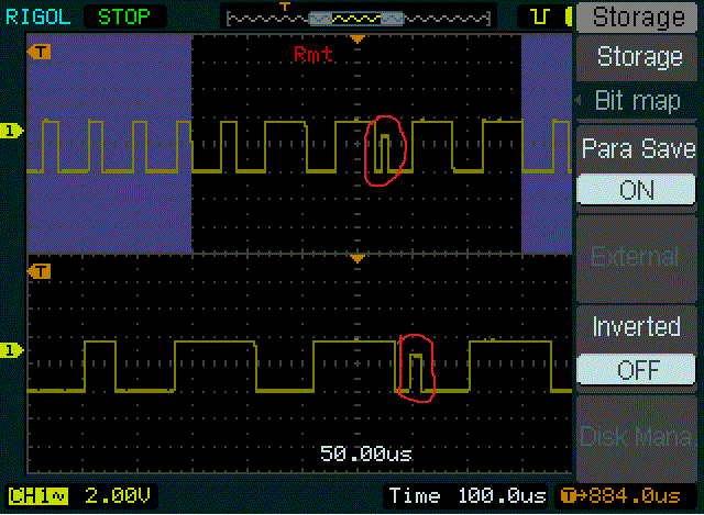

Hello!
It has been a long time, since I tried this sensor. Now, I managed to get it working, but only with DHT11. With DHT22 sensor, I am getting some kind of an disturbance signal while data aquisition. I happens always at the same time. And this causes, that checksum newer pass. I managed to record this error on oscilloscope, so that will be more clear. It is odd, that I get this with three different sensors. Does anyone has any idea, what can be wrong? I assume, that this is not software problem, because with DHT11 this newer happens.
