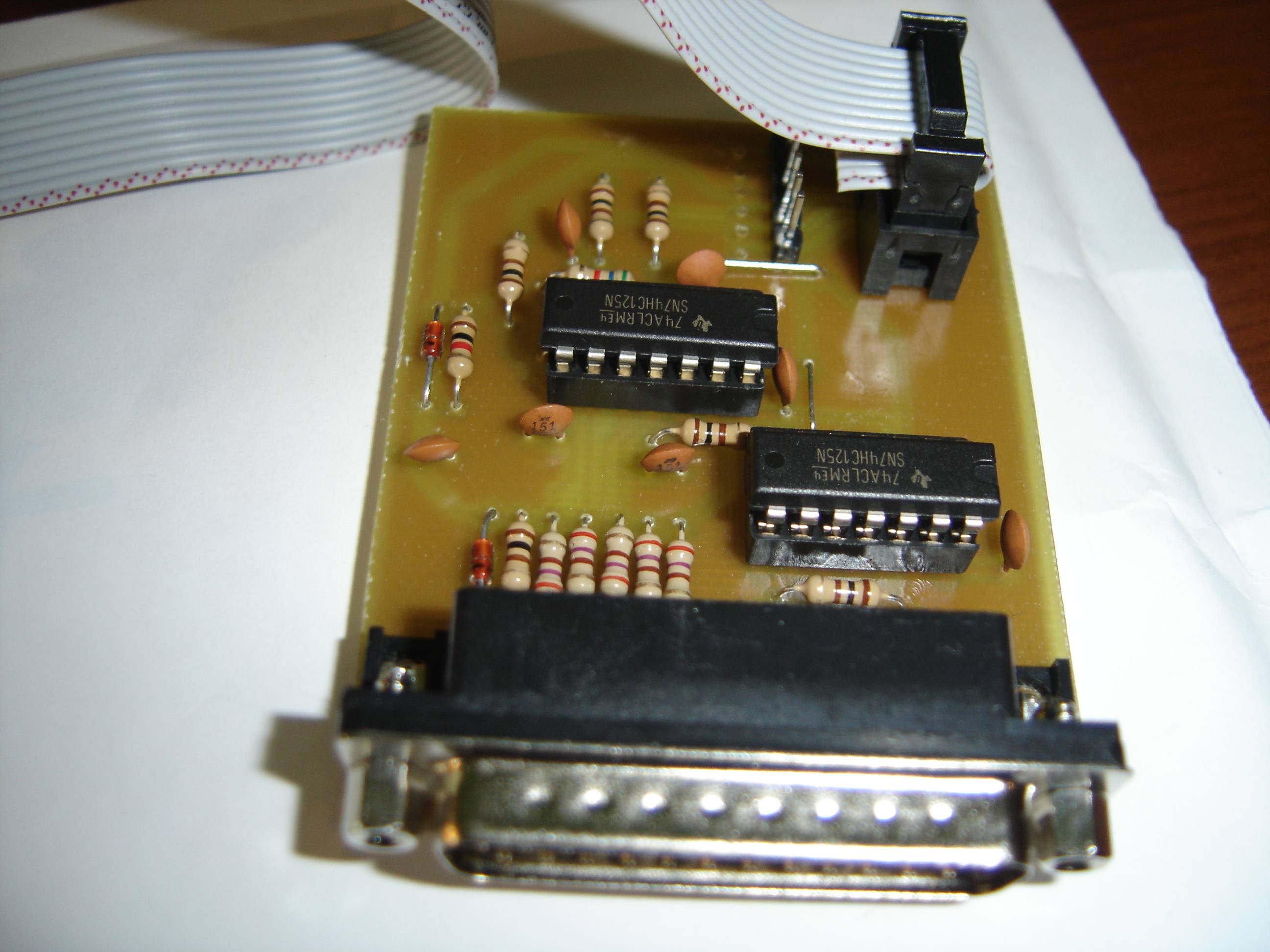

Programmer:
  • has enlarged pads for port DB-25
  • has added joint for programming 2x5 pin (it protects against inverse connecting the cable)
