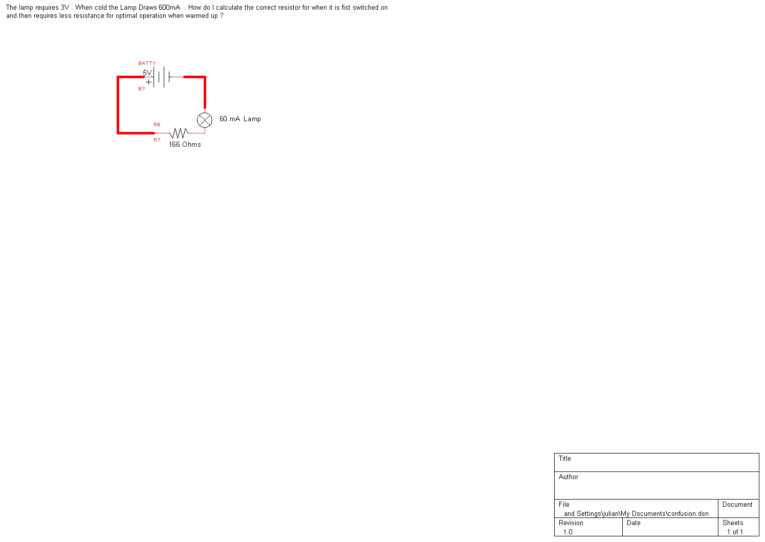

I need some help with calculating resistor values. Sorry the GIF is fuzzy and Lamp.png is the only picture worth looking at. thx for ANY help. Mike.
ps. Im doing a diploma in electronics and microcontrollers next year so hopefully that will help me a lot!
led voltage to current ratio
I have a 5V battery powering a lamp that requires 60mA . The lamp uses 3V+
I wanted to vfind out the resistance of the lamp -> 3/.06 A = 50 Ohms
When I want to calulate the current flowing through the circuit I also did this
3V/50 Ohms = .o6 Amps
So i need to drop the Volts by 2V..... 2/.06 = 33.3 Ohms
Does this mean all I have to do is use a 33.3 Ohmn resistor or there abouts ?
Thanks.
how to work out voltage, resistance
The lamp draws 600mA (0.6A) when its filament is cold and 60mA (0.06A) when operating. Normally you don't need to worry about the cold current when there is a resistor in series. You calculate the value needed to achieve 60mA with 3V across the lamp and let the filament heat up slowly because it is starved of current. As soon as it heats up, which is normally within a fraction of a second, the steady 60mA condition will be reached.
Your math is 'sort of' correct.
The resistor has to lose the excess voltage at the running current so the value is:
(5 - 3) / 0.06 which equals 33.33 Ohms.
The schematic shows 166 Ohms. It is difficult to predict what the voltage across the lamp or current through it would be because the characteristics of the lamp are not linear. As you can see from the cold current being 600mA and the warm current being only 10% of that, the filament resistance increases dramatically as it heats up. What it's resistance would be with the current limited by 166Ohms is anybody's guess, perhaps the lamp manufacturer specifies it in their data sheet.
A lamp specification is normally given as "the current that flows with the specified voltage applied across it and at normal operating temperature".
Returning to your earlier point about taking the path of least resistance; it only applies to lazy people, not electrons.
Brian

Thanks Brian. I made up that 166 Ohm using some crazy math i dont rember I think i was probably making some adjustment for the cold current?
Anyway I understood your explanation and now to request or look up data for components. Many thanks.
