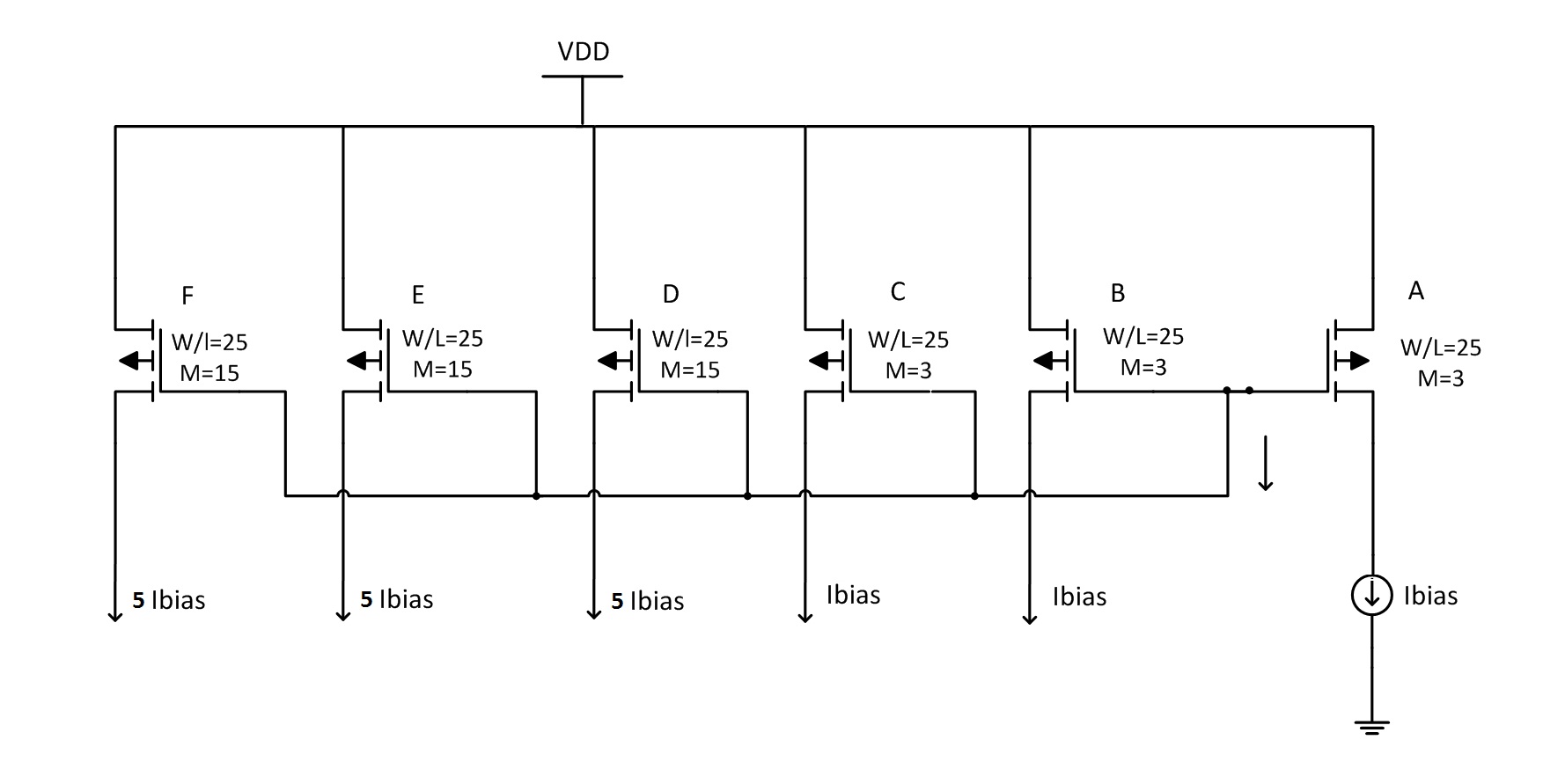

Dear friends(especially Erikl :))
I am trying to match the following MOS mirror , kindly suggest me a compact array according to common-centroied method please
Best Regards
Dear friends, before you suggest me, I have thought about this array
D E F X X X F E D

D E F X X X F E D
Where x is dummy transistor
how you find my array ????
Not too bad - but a nightmare for routing the layout. Hope this is a DC circuit, so routing symmetry isn't compulsory.
However: do you really need this 3:15 configuration? Wouldn't a 1:5 (or an even-numbered 2:10 , which is much easier to achieve regarding common centroid) configuration also be sufficient for your small-mismatch requirement?
In any case you need dummies around the whole array to guarantee a continuous environment also for the border devices, otherwise even a darned good common centroid symmetry would be useless.

I have no problem at all to choose any value that give me K=5, by 10/2 or 5/1.
However I have chosen m =3 for the transistors A,B,C to match them together inside the the whole array. my supervisor told me this, it didnt come to mind that I can do it with 2 because they are three transistors. you just now told me and I thought about it to be like
ABC
CBA
Anyway, I have given the result of my schematic according to that division and I can not change it now, the important thing for me is that the array I have proposed is ok although you are saying not too bad...... it mean bad :) but if you take a look again to the array you find that all the variables are centred in the middle of array
Regarding the dummies, Mr. Erikl, in this case every array I have to surround with dummies from all sides.
Regarding the area of application, the first one is in the biasing circuit which is not effected by the routing or parasitic capacitance symmetries. but the second is in the current mirror amplifier that I am wary about.
Please if you have more suggestion specially about the array still I will also appreciate it, you are my layout teacher Sir :)

I forget to tell, how could you match three transistor (A, B, C)with m=1 ????
I think
DDDADD
EEBEEE
FFFCFF
... with dummies all around would be good enough. Not really common centroid, but saves a lot of Si real estate, and is much easier to be routed.
Would be interesting to compare MC mismatch (+ process) results of m=1, 2, and 3 layouts!

yes you are right about the complexity of the routing, but this is price you must pay when you use the common centroid method, and now I can not imagine a current mirror with for example 10 branches , however it is comin to my mind that for this case one cane mirror the current to another mirror then recover it back again with another mirror

Sure, but this could create the same mismatch inaccuracies!
