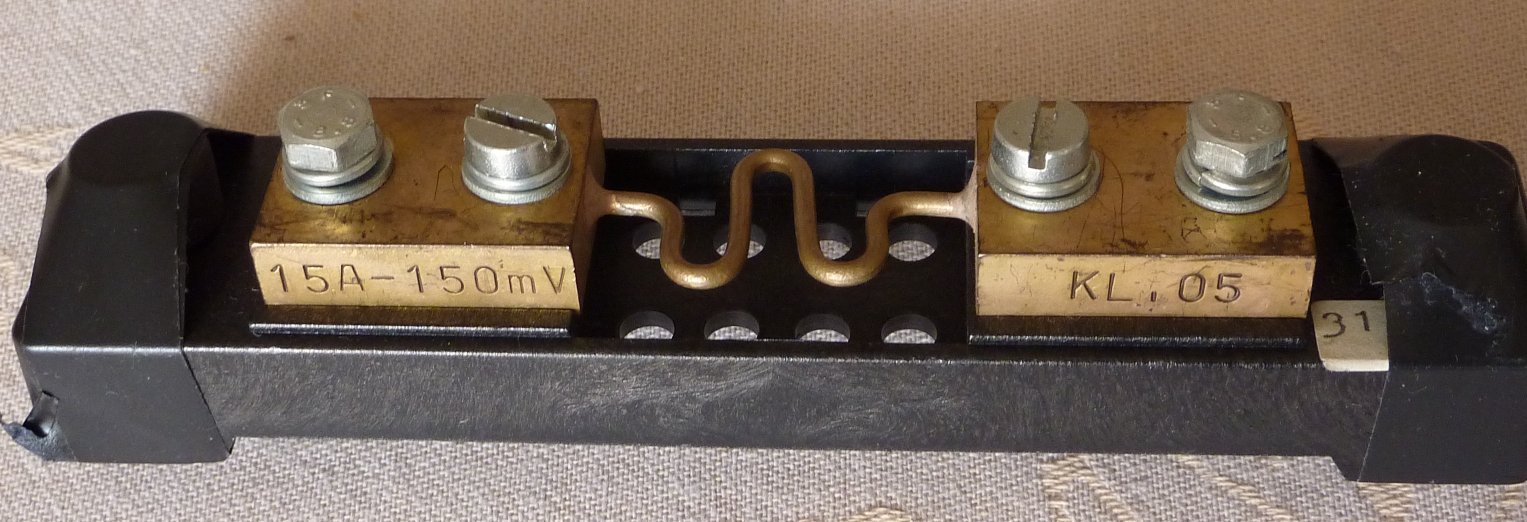

but diffcult to imagine, when we compare with the size of a shunt 0,1V 15A

As additional, your second picture is current shunt for 15A (150mV). Resistor as current shunt is not good for higher current, can do the job but its not good, he waste power, generate heat an lower voltage. At 15A you this shunt will decrease voltage by 2,2V. ACS712 have lower impact on voltage and current in measured circuit, A1302 dont have at all.
nota: shunt 15A will decrease voltage by 150mV only .. it's the given value of all the range .
but i don't want to use it because no galvanic insulation
