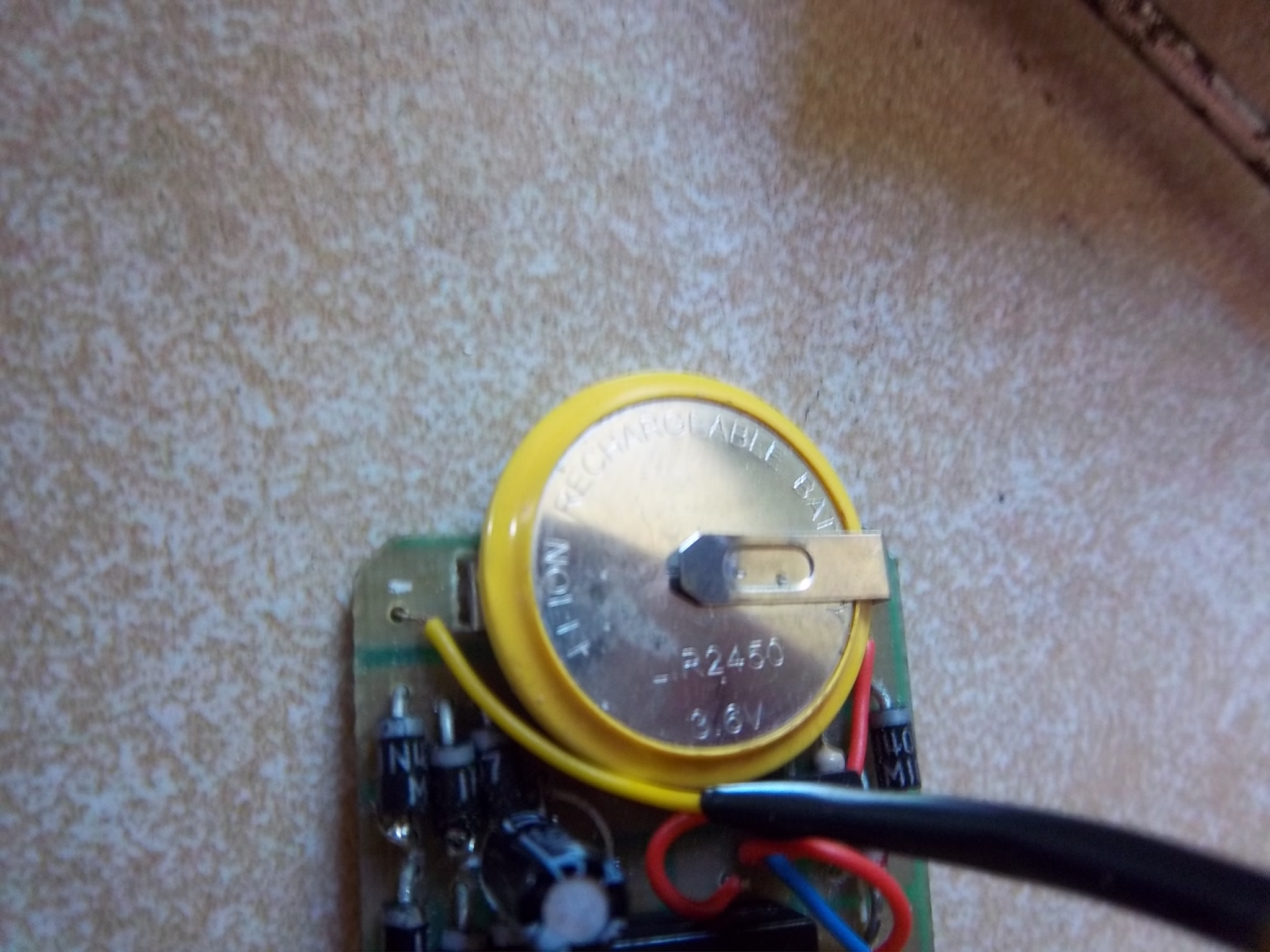

The dynamo came from a crank flashlight, yes. I am attempting to find a location online to purchase a crank dynamo that is NOT part of a flashlight but just the unit itself. That way, I can get the parts I need to do what I need. Any ideas of where to find JUST the motor and crank without it being in a flashlight?
Here is a picture of the crank mechanism in the project enclosure I am using. I also took pictures of the battery and circuitry that came with the rest of the flashlight. The battery is a 3.6v lion with a model number of: LIR2450. It will not do what I want, but maybe showing the battery that was originally used can help you help me! :)
seen the photos . are the red color wires goes to the three pins to a black box shown in photo5 ?
can you trace the circuit from pcb ?
The three red wires go to (i think) a group of transistors. They are on the left side in the center of the board in all of those pictures.
Do you just want a picture of the underside of the board or something?
i mean the circuit traced from the board.
instead better connect a voltmeter to two terminals of the three and carnk and note the voltage reading.
in that way you can go ahed with your requirement.
you can just mark each terminal and take any two out of three and you will have 3 sets .
measue.
