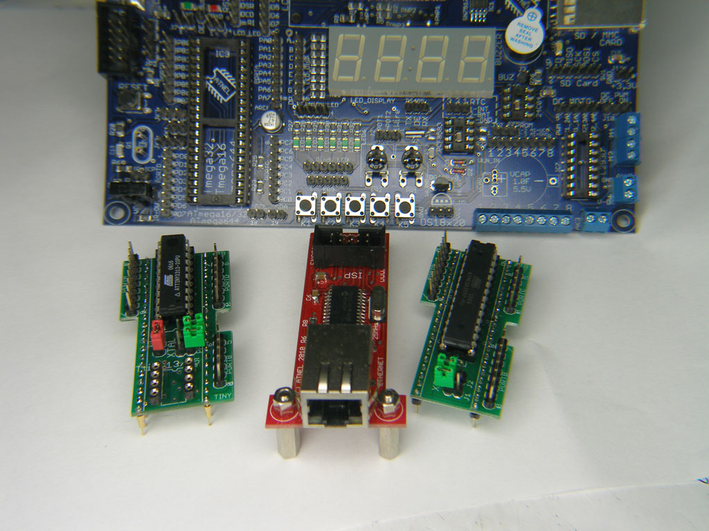

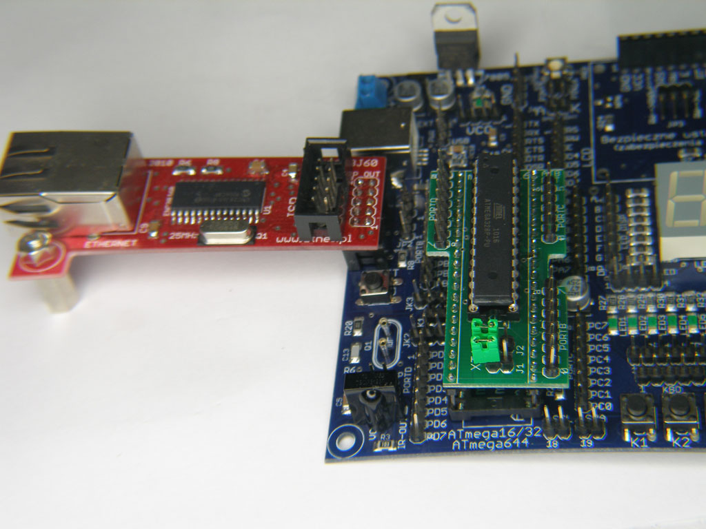

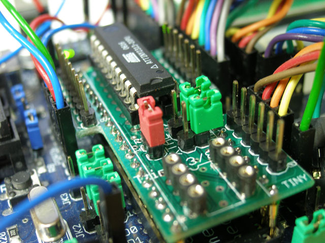

It is a useful development for a test panel. Few converters for different processors are made so that after their connecting to the processor, the nature and functioning of the test panel as a whole does not change.

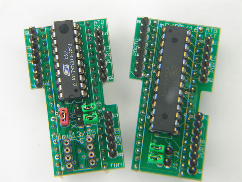

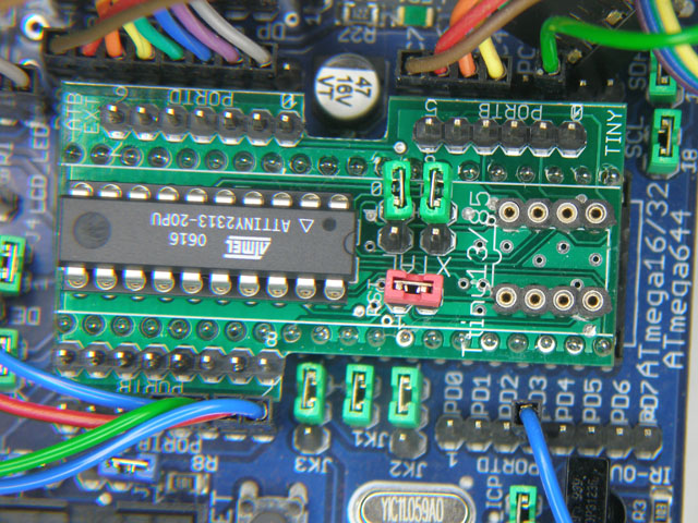

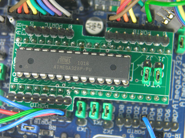

Converters are available for processors:
  1. Atmega48, mega8, mega168, mega328
  2. Attiny2313 and similar
  3. Attiny13, tiny25/45/85 and similar
  4. Attiny26

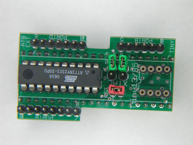

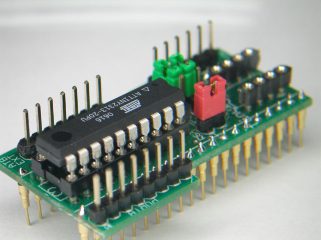

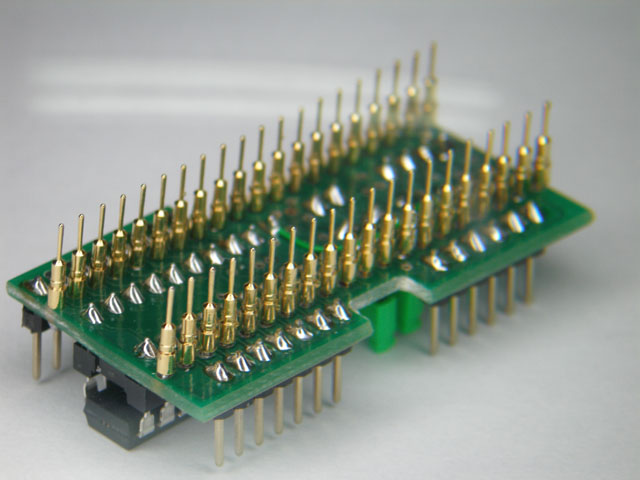

Sometimes there are 2 stands on one board for two systems, but you can use only one processor at once.
The programming connector is built-in the board. The boards of converters are equipped with jumpers so you can use the quartz from the board or disable/enable the pin RESET.
Pictures:

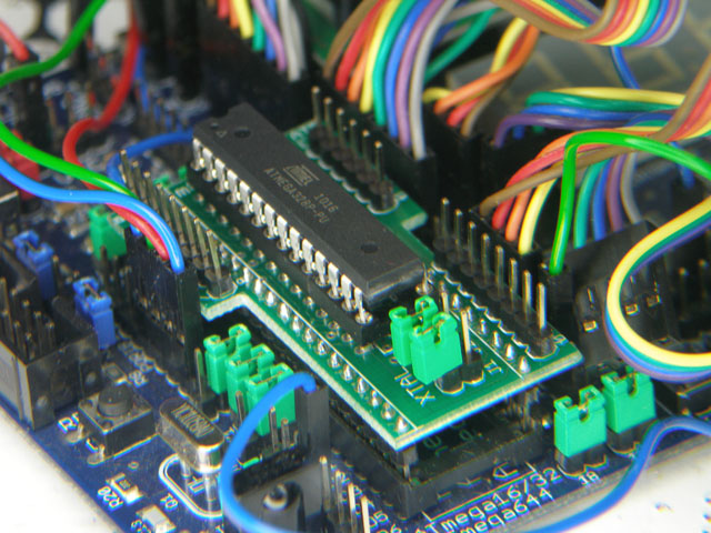

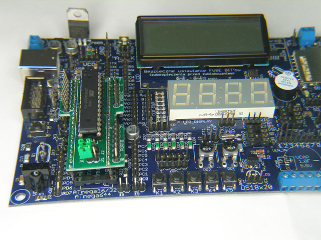

How the set presents in the current state:
Ethernet can be tested on a sample application from tuxgraphics.com based on processors: Atmega88, Atmega168 or Atmega328 (a lot of memory).
