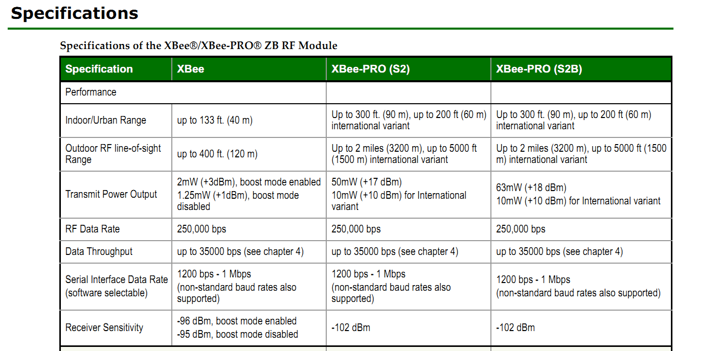

hi,
i started my project to connect zigbee with pc for data tranfer with high speed.should can i do?if no then why?
please reply me
hi, i see data sheet but i want to improve data transfer speed what should i have to do?plz reply
I presume you're actually talking about throughput? Zigbee (802.15.4) is not designed for high throughput. It is designed for low power, small connected devices use. Use something else, like WiFi for PC transfers.
i know about low data speed...but any other idea to increase data speed with zigbee?if u have circuit of xbee pro
then plz send me
You can't speed up the flow of water in a tap more than fully open. Zigbee protocol can't be 'sped up'. (Again, I assume you're
actually talking about throughput).
I don't use Xbee, so I don't have a circuit for it unfortunately. However there are lots of resources on it, even youtube videos when
I googled it.
