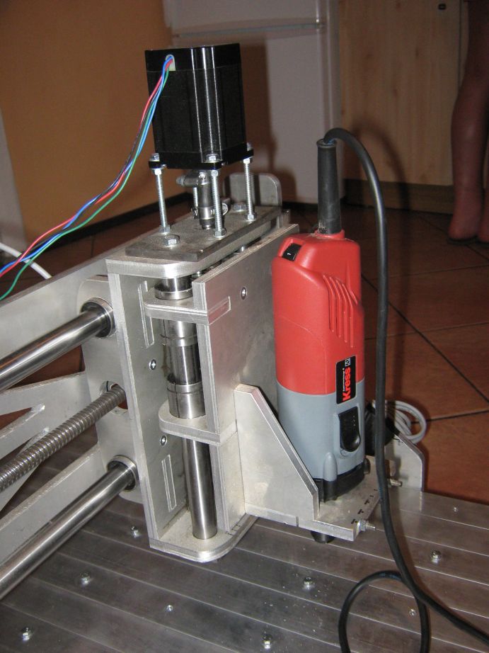

The work field's dimensions are 550x330x100mm. The milling machine was made of aluminum plate 10mm on an industrial plotter. The table was made of profiles riveted together and in the centre of each profile there is a flat steel with threaded holes. The device successfully cuts through various materials (plexiglass, plastic, bakelite, aluminum).
