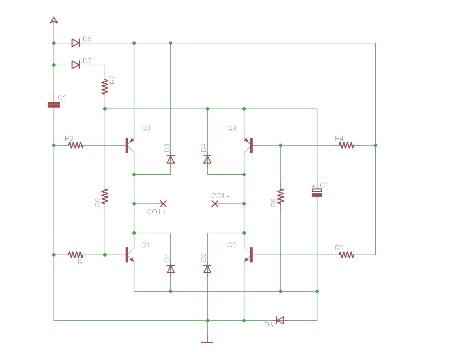

I have successfully reverse the output polarity to my magnet coil marked 'Coil(+), Coil (-)' with DPDT relay to reverse the North & South pole so when power removed the magnet will release with sourcing current from C1, R1 prevent power ON surge.
I'm wondering how can I done this with transistor?
Will this circuit also provide back EMF?
Pls see attached photo & advise me.

Hi Goldsmith,
The C+& C- connect to a non polarised electro magnet which I have to reverse its polarity to release using current that stored in C1 when power removed.
Thanks!

pls look at my circuit again.
When the power applied, the relay coil energised.
NO closed contact, C1 charged thru R1.
When power removed contact open, C1 supply the magnet with reverse polarity (NC contact)just enough power to release a metal plate which attached to the magnet when power applied.
What I need is replace the relay with transistor will this possible & how?

See below , please :
If you change v7 , to +15 volts , the voltage across the resistor will be reverse . ( remember , if you change v7 to +15 , you should change v9 to zero , and vice versa )

hi Goldsmith,
thanks for yr reply.
I dont have other power source rather than the main 24vdc. I cant figure out how to change the 0v to 15v or vize verse. Was the v7 & v8 replace with capacitor?
Hi again
It is an example . just you should know , supply voltage should be equal with V7 or V8 . ( if your supply is 24 m thus your V8 or V7 should be 24 volts too.

Hi Goldsmith,
I just figure out the circuit. It works perfectly.
Kindly see attached schematic.
Any comments or advise are welcome.
Thanks!
Hi again
But why these high numbers of components ? because your load is inductive you can use a diode in parallel with the CE of each transistor , but another components are not important . because your frequency isn't high .

hi Goldsmith,
Thats the min. parts I can do.
Actually its not switching but reversing the output to the inductive load for a second of time which determine by the value of C1 when power removed.

hi Goldsmith,
Will 1n4148 diode sufficient for the transistor CE junction?
thanks!
thanks!
Hi again
It depends on :
1- your maximum current
2- your maximum voltage
