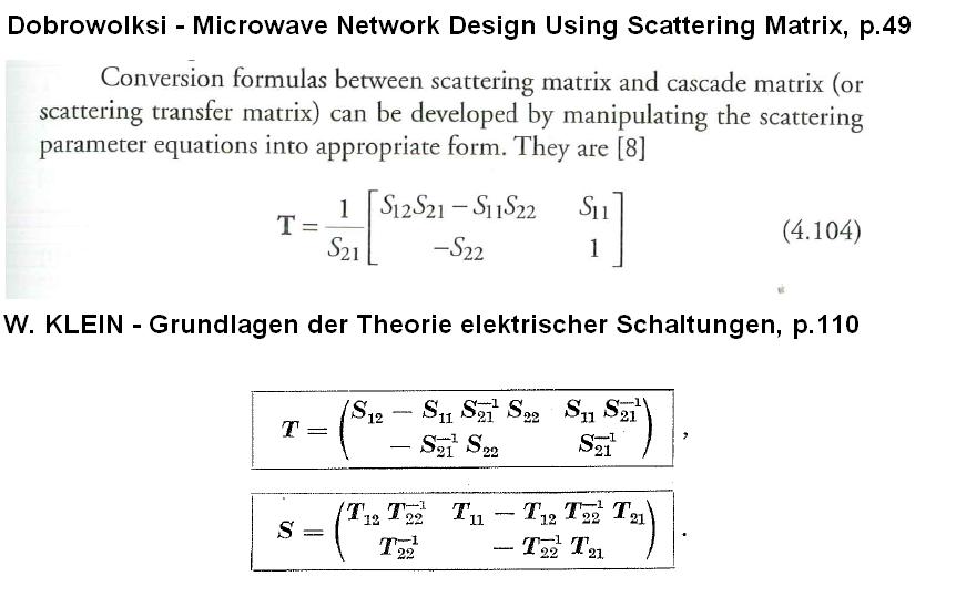

Hallo,
the chain matrix of a simple series impedance network can be expressed
as
C=[ 1 , Z ; 0, 1 ]
translated into scattering parameters, we get
S=[ T21/T11 , T22- (T21 T12)/T11 ; 1/T11 , -T12/T11 ]
S=[ 0 , 1 ; 1 , - Z ]
Does anybody see the mistake. The series impedance should be
symmetric. Here we have S11=0, S22=-Z, S21=S12=1.
Thanks for your comments.

Anyway, there seems to be a mistake. The formula I use for years should read like this:
S=[ T12/T22 , T11- (T12 T21)/T22 ; 1/T22 , -T21/T22 ]
This way the following C, S matrices correspond:
C=[ 1 , Z ; 0, 1 ]
S=[ Z , 1 ; 0 , 0]
The picture shows screenshots from two different books.
---> Well, I think
C=[ 1 , Z ; 0, 1 ]
may be valid for the so called ABCD matrix (voltage, current based formulation).
But it has to be wrong for chain matrix formulation.

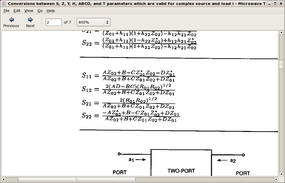

The scattering parameters of simple series impedance network should be
S11=S22=(Z/Z0)/(2+Z/Z0)
S21=S12=2/(2+Z/Z0)
Which gives a different chain matrix ...
Actually i'm not familiar with T-parameters very well. ABCD parameters of serial impedance A=1 B=Z C=0 and D=1 and if you use the following conversion rules
the answer seems to be right
S11=S22=Z/(2Z0+Z)
S21=S12=2Z0/(2Z0+Z)
Regards.
Ok, problem solved. Thanks ...
