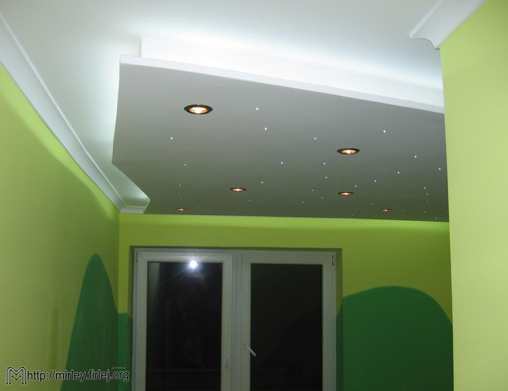

This project can be a part of architecture of lights in the house. Nowadays the energy saving target is really important, so the light was based on LEDs in various forms. They are LED “bulbs” in the housings for typical ceiling halogen holders (230V supply), strips of SMD LEDs and classic diodes in the housings for thread mounting. The system was divided into 3 modules: two executive systems and a controller based on the Atmega162 microcontroller. The controller allows you to light sequentially up to 12 halogen lamps 230V (using the executive system with triacs), regulates the brightness of the LED strip 12V and simulates the sky with stars in the form of 40 blue LEDs operating in 8 independent channels. Starry sky can operate in different modes of animation, and the substantial resources of the microcontroller program memory (16kB) allow you to make almost any passage of light. The program in its basic version is not even half the available space, so it can be developed. The controller support is possible by remote control RC5 or four classic flush-mounted switches. The system provides automatic turning off the lights after a break and return to the power supply.

The most problematic thing to make is the suspended ceiling with LEDs and halogen lamps. The model project uses 10 halogen lamps, 40 blue (stars) and 6 white diodes (placed in one line) in the hole housings and 10 meters of strip with SMD diodes in white. LED strips are controlled by the executive system built in the controller. The same is with 6 white LEDs. Halogen lamps are controlled by the executive system of 12 triacs (the system can be upgraded with two additional lamps). Two executive modules connected in parallel with the controller are used to control the blue LEDs (stars). Each of them can control up to 32 LEDs, however, in the model project one module controls 24 and the other – 16 diodes due to the size of the ceiling. Flush-mounted switches are connected directly to the controller, shorting its appropriate output to the mass. Power supply is connected to the system permanently by 12V/60W AC (inverter), the controller works all the time, so at any time the lamps can be turned on by remote control.

The model system is powered from a 12V 60W switching power supply designed for use with LEDs. It is not a requirement and you can use the classic power supply with a transformer. Adequate current capacity is important to remember, which in the long LED strip will have to be of several A.
Using the converter as the power supply you have to remember to connect it to the grounding. Failure to do this will result in that on the output of the converter there will be alternating component with the value of 110-120V, which at the extreme cases can be dangerous. Alternating component on the low voltage output causes also another parasitic effect. When the LEDs are off (the controller cuts off all the control transistors) and are connected only from the 12V, the alternating component is rectified on LEDs, causing a small current flow, and thus makes all the LEDs light (very poorly, the effect is visible in total darkness). If the grounding connection will not eliminate this effect, measure the AC voltage on the low voltage supply mass relative to zero in the grid. You may find that after all it amounts to tens of volts. Just short the mass of the system to zero in the grid (or for better grounding, if available) through the resistor 47-100k.
