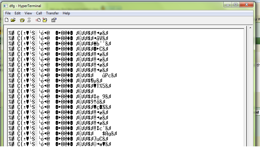

Still getting garbage out. Even after clearing the flag.
Can you describe the garbage?
Perhaps post a sample of the contents of t1 and t2 along with the characteristics of the test signal, frequency, duty cycle, etc.

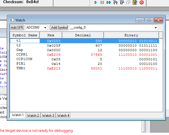

Think the problem lies that I still cant get PIR1.CCP1IF to clear ( despite clearing in the code ). I just debugged the code and relised that once PIR1.CCP1IF is set to 1 , it doesnt clear. Quite weird. The output on the hyperterminal is shown in the attached image.
Input :
Pin: RC2 (CCP1)
Input Signal on RC2 : 20 Khz , 5 V , 50% duty cycle [from function generator]
uC = PIC18F4620 on PICDEM 2 demo board
Sample t1, t2, Gap.
Interesting, I presumed by referring to the output as garbage, you meant the numerical values made no sense.
However, in this case the numerical to ASCII string conversion does not appear to be functioning as expected.

The issue with the numerical to string conversion is entirely separate from the capture timer issue.
Although not the correct value, Gap does contain a reasonable positive value after the capture operation.
If you manually set the variable Gap to a numerical value and then have the ultoa() routine perform the conversion what is the resulting string?
Can you successfully output a string stored in the character array str?
BigDog
BigDog
Hmm looks like I cant. I manually set Gap to 10 and getting following on screen
E†
E†
E†
E†
E†
E†
E†
E†
E†
Works with itoa(Gap, str) though. Im getting 10 on screen finally.
