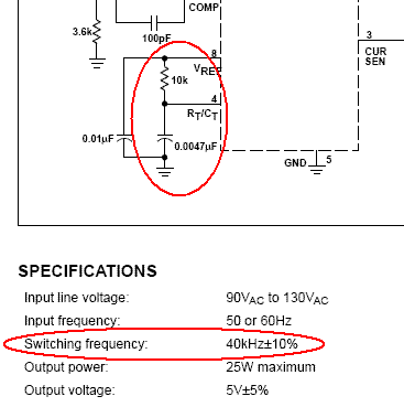

Hello
as you see this schematic the frequency is 40Khz
but i calculate the frequency with two formula and find the equvalent capacitor with Thevenin.could you help me on this?whats formula and the way to calculate.

Hello
i found and calculate with these formula that both of them return me the same result but it is different from the circuit schematic frequency that i show at the first post
could you calculate for me?
could you define the equation and how they create 40khz frequency?
Ceq=.0018 microfarad (Thevenin)
R=10K
so frequency should equal to 95Khz not 40Khz
if we assume on of the Capacitor instead of Equal Capacitor we have
C1=.01 microfarad
R=10K
F=17.2Khz (not 40Khz)
C1=.0022 microfarad
R=10K
F=78.18khz(not 40Khz)
how did they find 40Khz frequency?

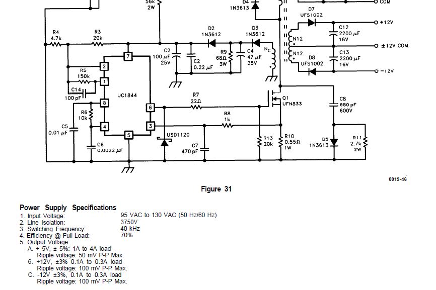

I think there is a mistake in the Texas datasheet. The graphs give the same answer as the formula, but the circuit has wrong values.
The NXP/Philips datasheet has a circuit with correct values. You can find it here: https://pdf1.alldatasheet.com/datasheet-pdf/view/19833/PHILIPS/UC3842.html
I looked at datasheets from ST and Fairchild too. They show the same graph and same formula, but no example circuit to compare.
Reactions: baby_1
    baby_1
Yes godfreyl
your right.i calculate the NXP circuit with the formula that i indicate the frequency is 37210.2Hz or 37.2Khz
