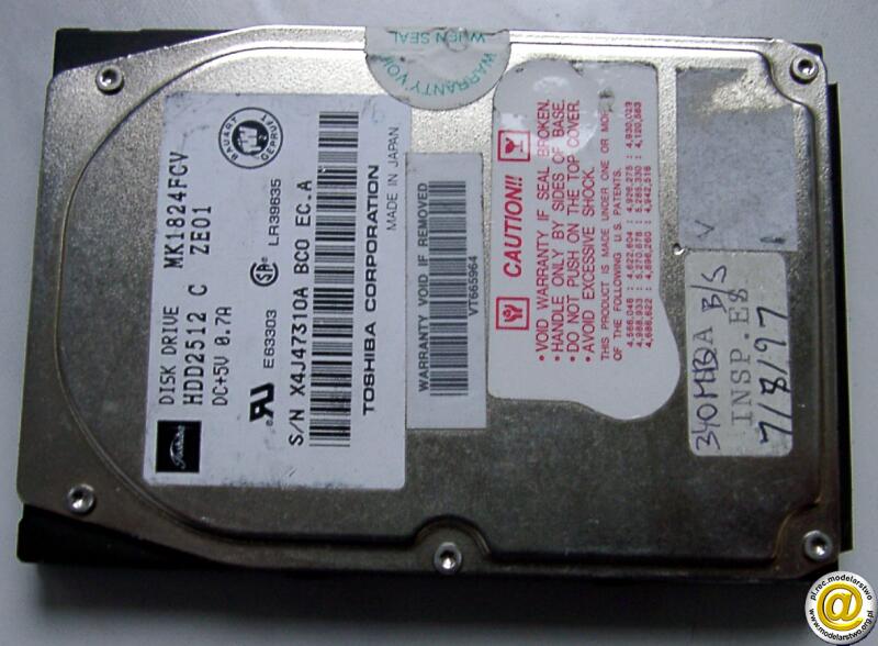

Another way to get materials to build your own brushless motor is to dismantle the old hard drive of a computer. The disk may be damaged, just plates drive motor is important. Suitable are engines from disks 3,5” or 2,5” with a capacity of at least 200MB. Capacity is not important, but the engine itself. In older drives (20, 40, 80, MB) engines with 4 or 6 pole pairs were used. For our purposes, we need a motor with 9 or 12 pole pairs. Another selection criterion is the weight of the engine.
Dismantle the hard drive to remove the engine. To do this, unscrew the plated and heads. NOTE: the magnet in the heads drive engine is very strong. Rest is useless for our purposes. The only things ever useful are the bearings on which the heads arm is mounted.
It should be done carefully in order not to kill any bearing seat, not wince the axle. In these picture there is drive 2,5”, but it looks like 3,5”. Unfortunately, the 2,5 inch disks the bearing seat is also the body of the disk. So cut the right shape from the body, which will give the mount.
