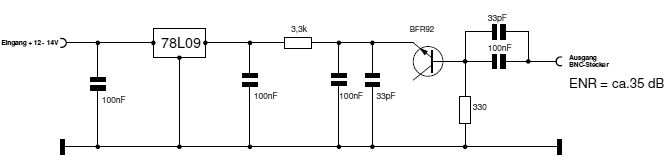

Try this schematic which works for me up to 2.5 GHz:
Yes, I use the same e-b diode in avalanche mode, only into 50 Ohms. If 330 Ohms is used, the output noise spectrum is not flat and at some spots it can peak to 35 dB ENR. The DC current is critical, my best results are for 5..10 mA. Almost any RF transistor e-b diode can be used, it breaks at 6...9 V.
Thanks, especially for the suggestion of a transistor junction...the noise diodes were going to be fairly expensive!
