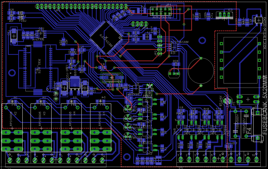

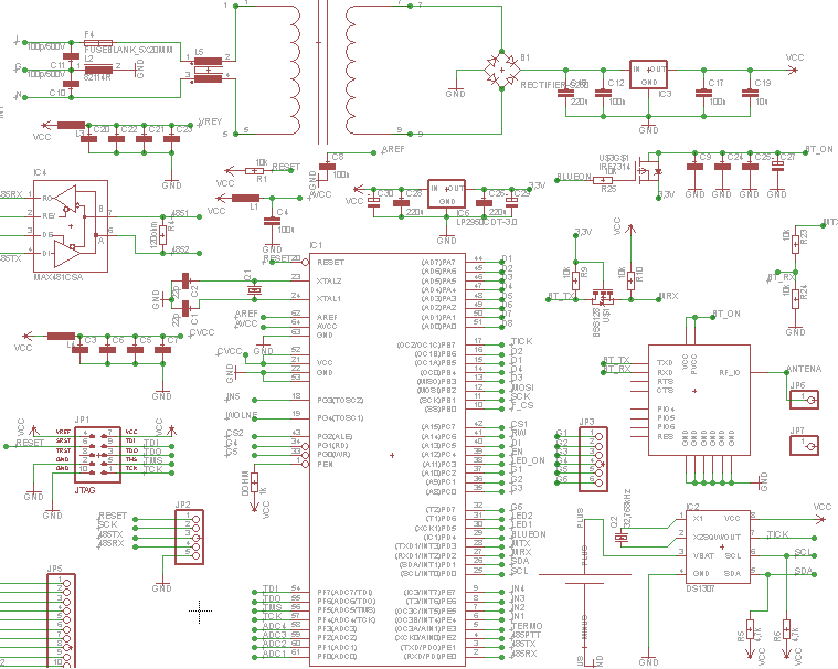

Bluetooth driver – control within mobile phone
Technical parameters:
  • 4 digital inputs
  • 4 relay outputs with NC and NO terminals. Output voltage range: from 12 to 30V DC and from 24 to 250V AC
  • RTC allows to determine the time of the event
  • Bluetooth communication module having a 100m range (class 1) BTM222
  • thermometer DS18B20
  • RS-485 communication output allowing the communication with other devices of building automation, it is possible to communicate using Modbus or BacNet protocols
  • outputs for plugging the control panel, consisted of a display, keyboard and a buzzer
Inputs and outputs are protected by optocouplers. From the power side, the system is protected by EMC filter to meet CE requirements.
Schema and board drawings are presented below:
And the driver:
