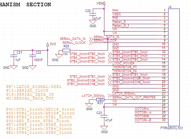

Update:
I tried removing the printer and tried to read Bluetooth data (without printing) and it worked fine. Tried reading about 200000 bytes with 2000 bytes every single time with a delay of a sec or two max and it worked well and at good speed.
When I connect printer and read the data and as well print, I am able to read the data for few KB (This is random) and then the data read/reception is delayed... Say for few seconds and then I get next byte... again prints properly for few hundred bytes and again hangs or say delay in data reception.
I would have activated strobes while I am printing and at the same time the bluetooth data is read in circular buffer (via UART receiver interrupt).
Is excess current drawn causing this issue. I see the voltage drop at the battery.
Some boards work perfectly fine but max dont.
I tried 4 strobes (Max current), 2 and even 1 strobe (low current) drive to check if it excess current drawn but couldnt get a clue.
Strobe current depends on what I am printing hence donot know exact current. Datasheet says if all dots of one strobe in ON it takes about 2.4 amps.
Could this be ESD?
Could this be current?
Is my regulator voltage (3.3V) varying... Seems stable when checked on CRO
Could that be some noise??
I am just not sure which way to go from here

Looks like you need someone to debug for you. THere must be an obvious difference in dielectric, from copper layout, silk screen or solder mask, the latter being more a clue with the number of solder prints being the trigger and noise injection from printer cable... try CM choke or better battery source....
What test debug / fault isolation is built into design? any?
I donot have any fault isolation built.
The IO needed to drive printer are directly connected to MCU Pins
VDM is Battery Voltage (direct), Strobe, latch, data etc all connected to MCU directly
I tried supplying saparate 3.3V to bluetooth only and its working fine.
There sure is some variation that is happening which I am not able to track on CRO. I closely looked and I saw that when the print starts the 3.3V drops 200-300mV (Approx) for about 7ms and comes back to 3.3V and when the printing is about to stop, there are lot of small variations on 3.3V
How and what measures can i try to make this signal to be rock solid 3.3 always
