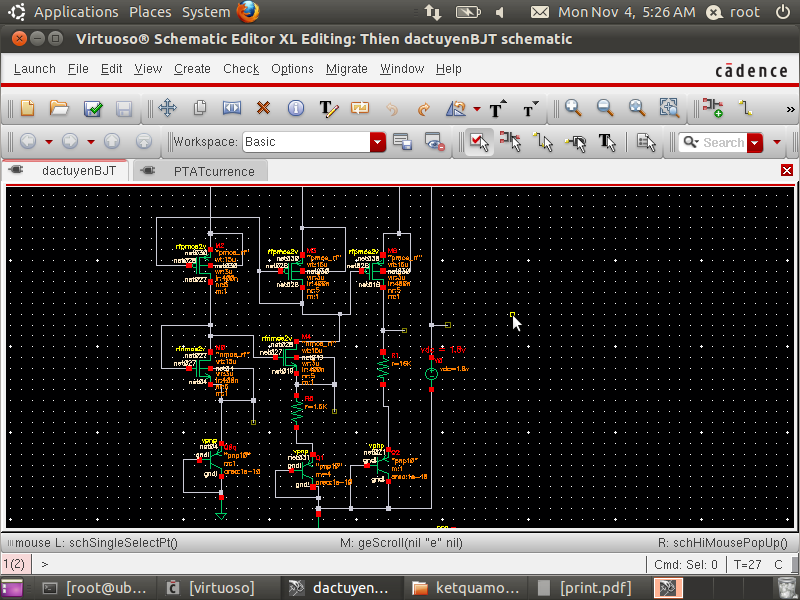

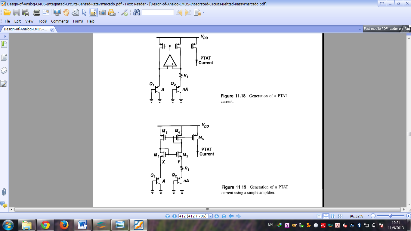

https://obrazki.elektroda.pl/6608223200_1383968299.png
https://obrazki.elektroda.pl/2422968900_1383968163.png
what do you think about these circuits?
I simulated in Cadence but results are very bad: Vout( from D of pmos M6) likes a line.
Can you point out my mistake? How can I improve it???
http://obrazki.elektroda.pl/6608223200_1383968299.png
http://obrazki.elektroda.pl/2422968900_1383968163.png
I simulated in Cadence but results are very bad: Vout( from D of pmos M6) likes a line, it increses about 0.01v/ K, that's terrible.!
... Vout( from D of pmos M6) likes a line, it increses about 0.01v/ K
Sure, because these are PTAT current generation circuits, not bandgap designs.
BTW: your schematic is virtually illegible. I can't even discover M6 .
