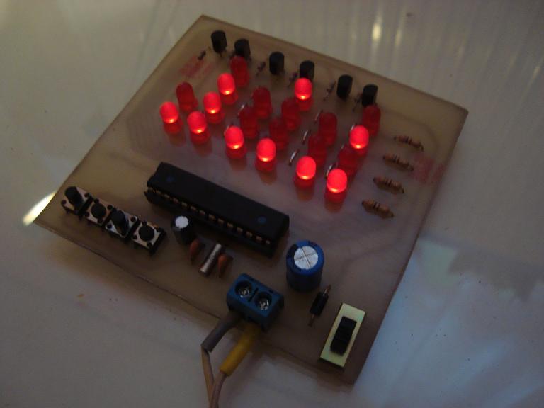

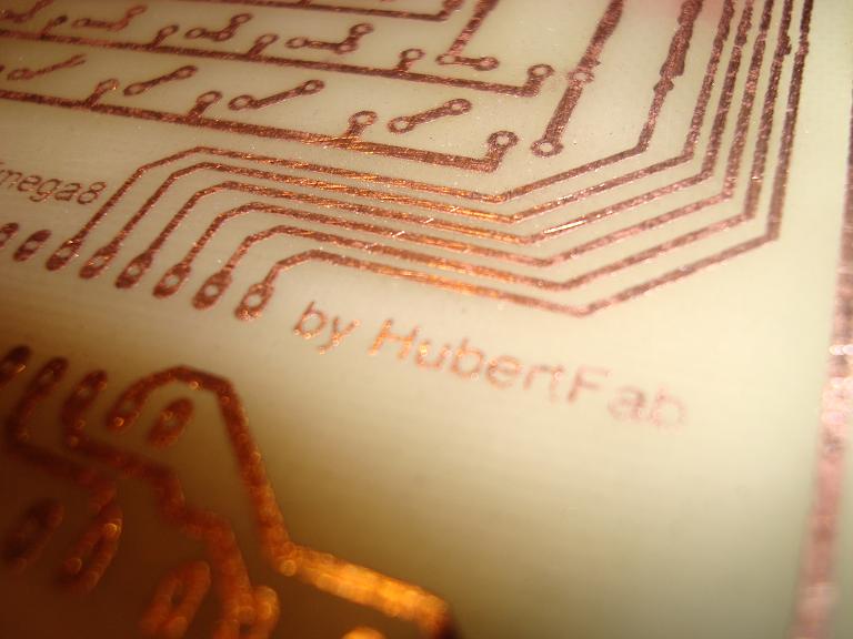

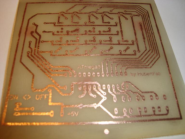

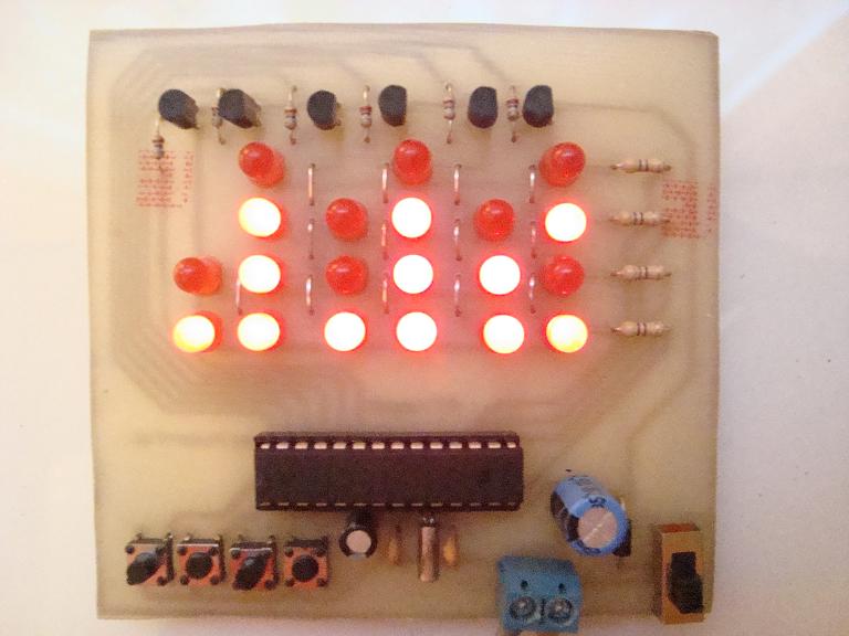

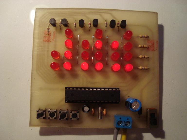

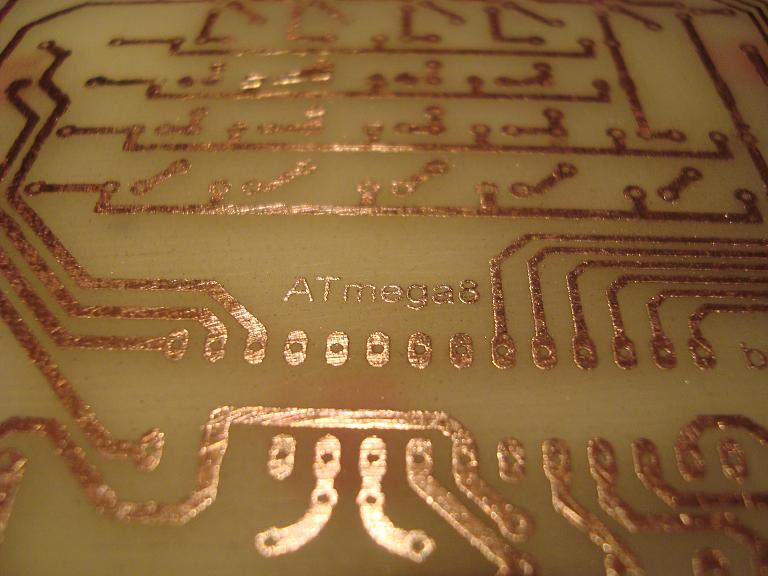

Binary clock with 6 column LED display
It is a home made binary clock. Time is displayed on 6 column LED display. Well known and popular microcontroller Atmega8 controls the device and countdowns time with watch quartz.
The frequency of multiplex was increased to 1,56kHz. It prevents flickering.
Power supply from 4,5V to 6V.
