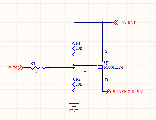

This is the circuit I came up with using a relay to isolate the battery when the MP3 player is running off the AC wall wort. The problem is that the instant the power drops out and the relay switches to the battery, there is just enough of a delay that the player shuts off. Also when power is restored the player again shuts off when switching from battery to the AC. I tried adding the capacitor to hold enough charge to keep the player powered up until the relay switches but this doesn't seem to work. Any other ideas?

Instead of using relay you can try using a P-channel FET with gate threshold of less than 0.5V. You can connect the source of battery via 10k resistor and gate with 1.5V regulator output. Drain will go to player supply. Inherent diode in FET will help you to charge the battery at lower voltage (may be 1.3 - 1.4V, instead of 1.5V). I think FET will be fast enough to let the plater alive while switching the power.
---------- Post added at 07:12 ---------- Previous post was at 06:51 ----------
I realized that gate will be left floating if source voltage will not present, and will cause FET to be off..
You can choose some FET like SI1307EDL, and connect it as figure attached.

You can use transistor for switching pupose instead using relay. . bc 547, bc 548 etc all will do !!! Moreover there will be no delay!!!
