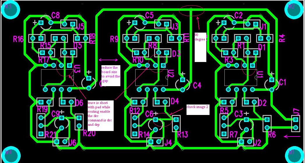

Hello Sir
please can any body tell me the rules to be followed while routing in padspcb
i have done my first routing in single layer.
please tell me the mistakes in the design
i have attached the schematic and pcb diagramView attachment SCHEMATIC1 _ Page - 01 ADC.pdf usha.JPG
First conform to me, you board is single side or double side. if you board is single side you have to take routing in bottom side only.
you trace width should be 12 mil for single side for double side more than 6mil is better.
for Power (+5v) single side 40 mil,double side 20 mil
Hi usha,
i need some clarification in your board from input of image.
1.your board is single side or not ? (if it is single side take trace from bottom only)
suggestion:
trace should not 90 degree,reduce the board size,use trace width minimum 12 mil for normal trace and power better 20 mil or 40 mil depends on amps.
refdes orientation like that only (see image i)
let me know the pad size ?

hi kapil,
thanks for ur suggestion
the board is single side
i have routed in bottom layer
i have taken the library parts of PADSPCB.not yet created any component
length cannot be changed as it require 95mm where width can be changed
