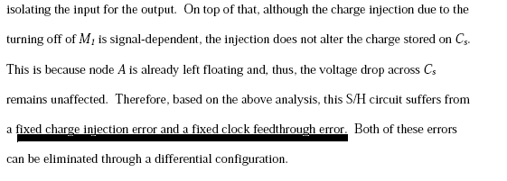

@checkmate:In document you have suggested it is said that we will have only fixed charge injection and fixed feed thru,but I'm getting signal dependent charge injection.
That's because you have totally disregarded that your problem has a parasitic component which I suspect is a major factor with a 5fF cap, and not only charge injection and clock feedthrough. You should really try to evaluate alternate architectures, or try some sort of interleaved architecture to lower your sampling rate.
What value of capacitance you think is appropriate?
one more question is if it results in only fixed charge injection and fixed clock feedthrough can't we think of its as only offset error and remove it using a level shifter rather using a differential opamp?

4. u will always have a some sampling error at inputs as long as this error is not signal dependent then u can consider them to be offset (dc errors) if u use differential structure the error is assumed to be same and will get rejected by the opamp due to its CMRR.
